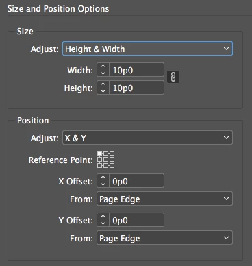

Hola comunidad. Tengo una consulta. Estoy diseñado en Indesign. Creé un campo de texto al cuál le asigné un Estilo de Objeto, y que quiero que esté en una posición determinada con respecto al margen. Tiene además un estilo de caracter. Bien, cuando modifico los márgenes de la página y coloco la opción de ajustar, ese campo de texto se modifica y queda "pequeño", es decir que la caja de texto me aparece como "desbordado". Si ingreso al detalle del estilo de objeto, las medidas son correctas, si ingreso al estilo de caracter, también.. alguién podría decirme porque sucede esto entonces? Muchas gracias!
Hello community. I have a question. I'm designing in InDesign. I created a text field to which I assigned an Object Style, and I want it to be in a specific position relative to the margin. It also has a character style. Well, when I modify the page margins and select the option to adjust, that text field is modified and becomes "small", meaning that the text box appears as "overflowing". If I enter the details of the object style, the measurements are correct, and if I enter the character style, too... can someone tell me why this happens then? Thank you very much!

In your opening post you said that you are using Character Style - you should rather use Paragraph Style.
No, it won't affect location of the Anchored Frame - it was just a suggestion - that's why I've posted a screenshot from the ObjectStyle options.

@SoyCecilia
In the ObjectStyle you can hardcode its size and position:
And you should use ParaStyle not CharStyle to format your text.

When you say ParaStyle, is Paragraph Style?
If the answer is yes, I don´t have the opportunite to set the position of the text in the ParaStyle.
I set it in the object Style, but, when I modify the document (changing margens) the text is "overflowing". Instead the letter sizes is the original one.
