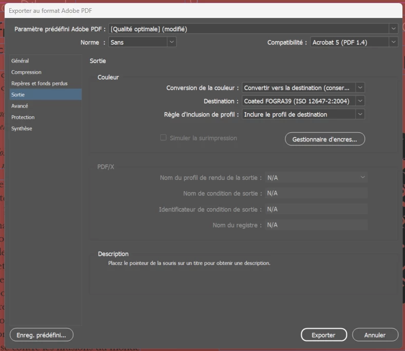

Hi @Sol_sha , Can you show a screen capture of the Output tab of the Export preset you are using? Also, if you check the black values using InDesign’s Separation Preview do they read as 4-color?
Sol_shaAuthor
June 11, 2024
Hello Rob, thank you for your answer. Here is a screen capture of the usual settings I use for the export. About the Separation Preview, no, it reads the black at 100% black, without CMJ. The problem exists also with an entirely black maquette (only text, interior of a book), in prepresse, it's a CMJN black, which is annoying because my printing is exclusively black. Thanks a lot for your help!

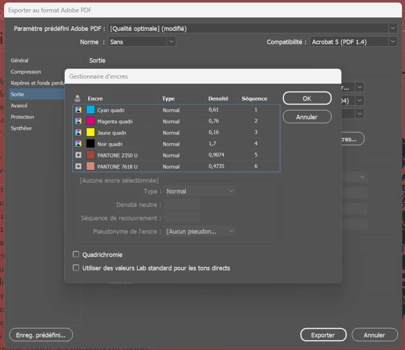

Sol_shaAuthor
June 11, 2024
I add that in the "ink manager" (I don't know the term in english, Gestionnaire d'encres in french) of the Output tab, I have indeed CMJ? But I don't have it in Separation Preview. I don't get it!
