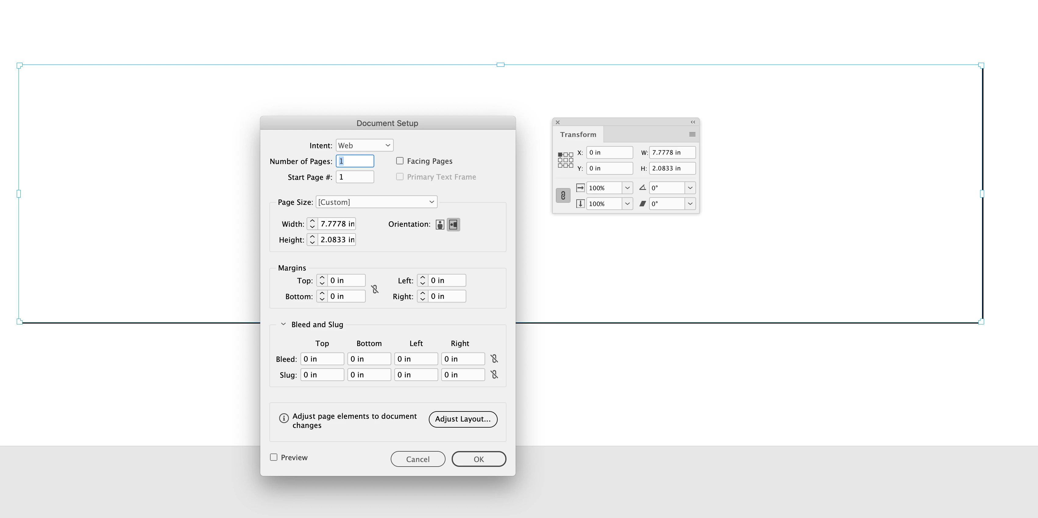

Also, an InDesign page is a vector object—it has no pixel dimensions or resolution.
Pixels in InDesign are a Ruler unit, if you set the Ruler units to Inches in the above example, the page dimensions will be 7.7778" x 2.0833". The JPEG Export dialog is asking for Pixels Per Inch—not a pixel dimension. 7.7778 X 72 = 560.0016:

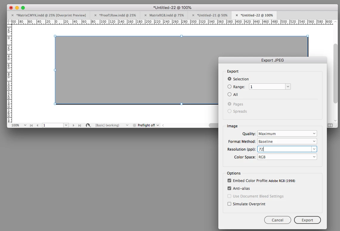

My dimensions are 560px (w) x 150px (h). I have no 'desired' width, the width is set up. So what should I enter in the resolution when exporting please?
I tried to just do 560/560*72 and that did not turn out at an ideal size or quality.
Thanks

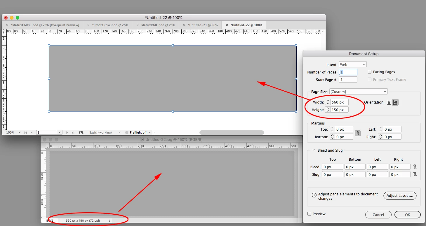

rob day
Dec 14, 2020 1:24 PM UTC
If your InDesign document’s dimensions in Pixels is 560 x 150 no math is required, simply set the Resolution to 72ppi in the JPEG or PNG Export dialog and the exported image will have a matching 560 x 150 pixel dimension when viewed in Photoshop.
