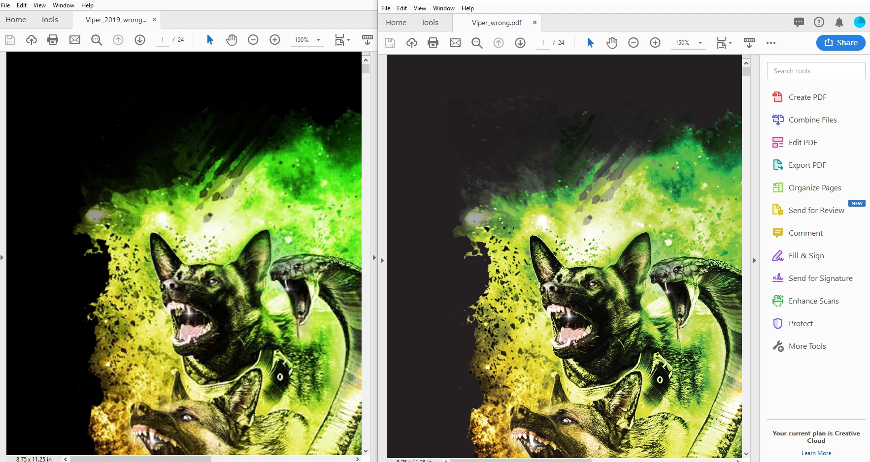

I get my bosses to review the content so I've been exporting as PDF "smallest file size" so it sends in email. Which results in the image on the left, grainy photos, but a rich black color. I don't care about the photos since my bosses are reviewing the content only and they are aware they are getting a low image quality PDF.
The problem is, I've exported the finished file as PDF "High Quality Print" and the images of course are super sharp, but it changes my black to a grey color which results in the image on the right.

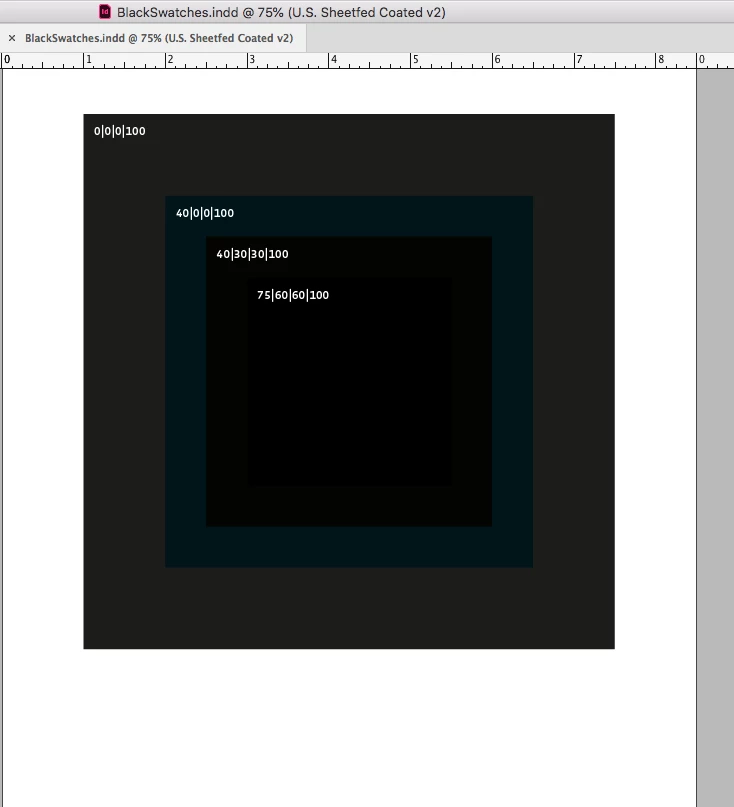

Litho printing inks are transparent, so black by itself is never absolute black on an offset press. The document’s assigned CMYK profile attempts to display black as it will print.

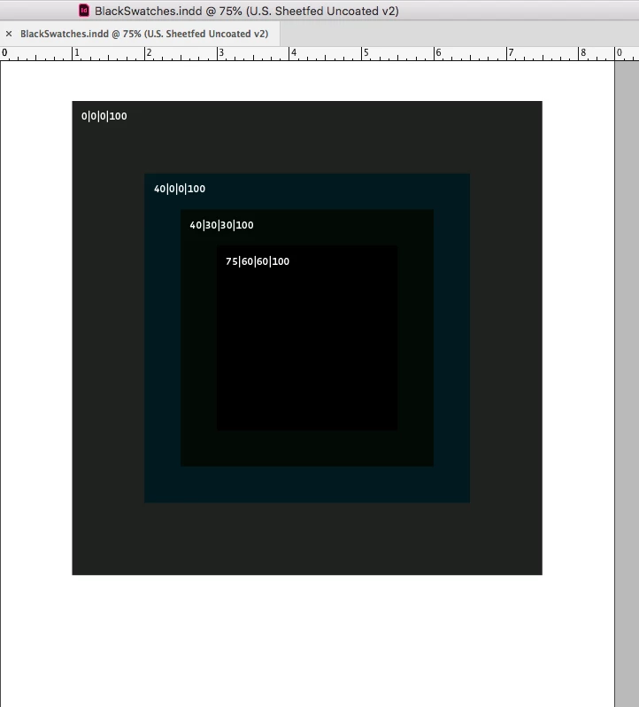

On an uncoated sheet the effect is more obvious, it is displayed with an uncoated profile US Sheetfed Uncoated:
US Sheetfed Coated:

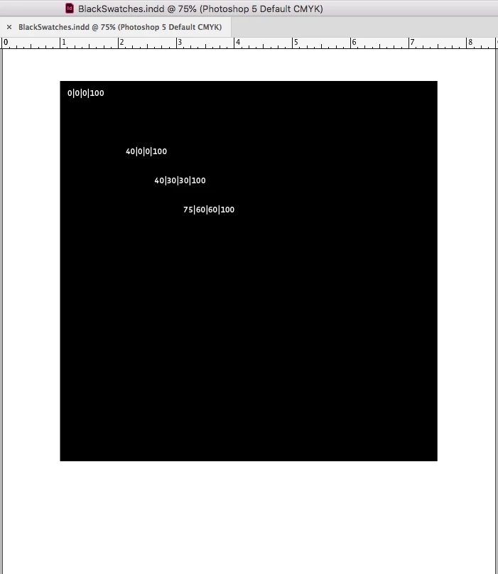

Legacy profiles like Photoshop 5 are less accurate and don't make the distinction
US Sheetfed Coated:

From your screen captures I get the impression you are referring to blacks in images, not vector elements. If that is true, one question is what color space is the image now? The PDF preset "Smallest File Size" converts color to sRGB. Doing so will give a "richer" appearance on screen, but of course will never be ink on paper without further conversion. The PDF preset "High Quality Print" leaves color unchanged. So again it all depends on what the image color space is to begin with. Were it RGB, likely either preset would give the same result. However, I will guess the image is CMYK, and probably converted to CMYK using Web coated (SWOP) profile. So yes it will look "less black" because that profile is for web press (think newspaper) the standard for which is 300% total ink coverage. But if the job is printing commercial sheetfed, and particularly on coated stock, going up to 340% is going to look a lot blacker in the final result (and likely even more on screen, though not ever as black as RGB appears). If printing commercial sheetfed, use GRACoL profile which is higher total ink. Best workflow is keep your images RGB (whatever you prefer, sRGB, Adobe98, etc.) and when making PDFs use PDF-X/4 preset but convert color to the desired profile at the last minute. Then you can easily switch printing conditions if needed, like changing from SWOP to GRACoL without having to go back and re-purpose every image.

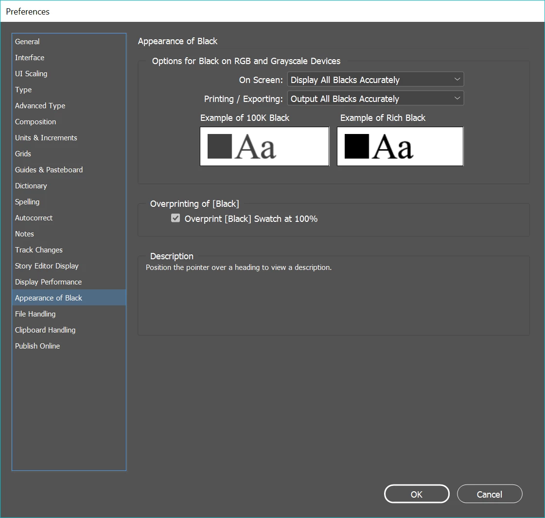

Also, I always change my black prefs in ID and AI:
