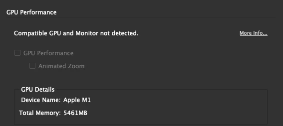

I can not use the GPU check box fix as that is a grayed out setting. Help. I use ID all day at work and this bug makes my job at work impossible.

> GPU performance is greyed out for me.

Guys--once again--some of the Macs out here do not allow you to change the GPU rendering setting such as the M1 Mac Mini. Again, the flashing screen *did not happen* before this new Mac OS X Sonoma update. Turning off rulers also does not stop it on a majority of computers out here.

The Mac Mini has the GPU option grayed out/not supported. Rulers on or off has no effect. Tried all the Display Performance/General preferences tricks mentioned here. Everything is 100% udpated. Cannot roll back (company computer).
