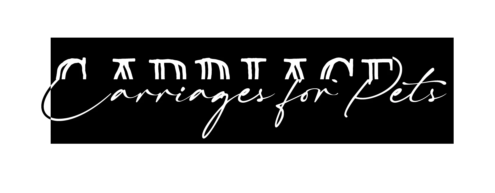

Hi there, I've got an iMac 2021 and in Indesign, when swapping from one font to another (or even a size or weight), why can I still see both fonts (or half of one font and half of another)? Its clearly an error or screen problem but how can I fix this. My old iMac from 5 years ago doesnt have this problem. Can you help? Many thanks...Simon T

If it's on, try turning off GPU performance in the Prefs. That seems to affect a number of other screen draw issues.

This sounds like a screen-redraw issue.
Does it go away if you change your View percentage?

Hi Brad,
Yes, it goes back to normal via percentage or scrolling through other fonts, but really really annoying.
Have you seen this before, is it fixable or a hardware problem?

Peter Spier
Peter SpierCommunity ExpertCorrect answer
May 22, 2022
