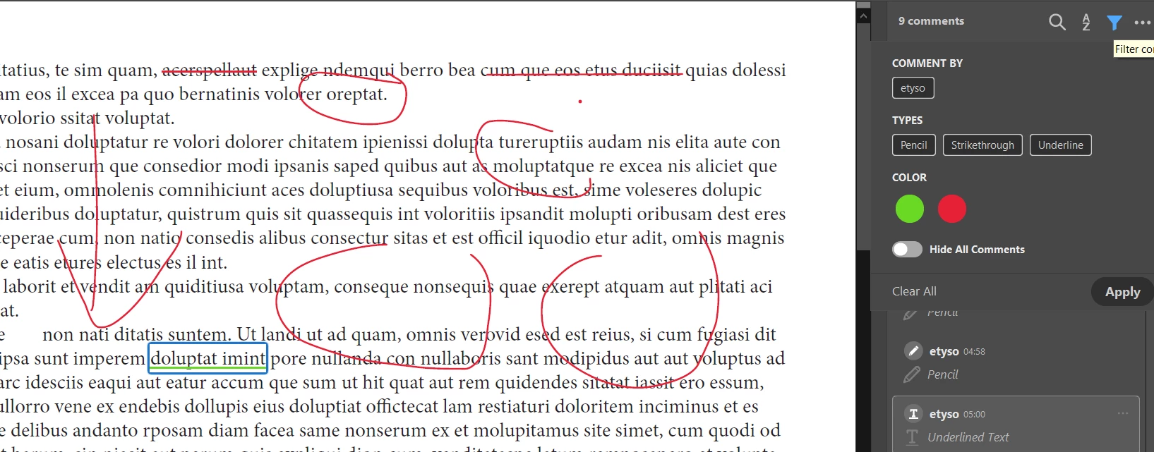

Probably many of you are familiar with the problem described in the title.
For me the most frustrating part of the typesetting process in InDesign is lagging while applying corrections from comments imported from PDF.
I always suspected that it has sth to do with CEP HTML Engine, resp. Libraries.
But it seems that the source of the problem are... pencil markers (drawing tool) applied to the pdf in review.
InDesign manages to import them along with all the other corrections, comments, markes and insert them on layout. But when you try to do ANYTHING on the page or spread containg pencil marks, it completely freezes. As soon as you delete these markers in comments panel (which takes a while...) [three dots / delete], everythng comes back to normal.
So: simply FORBID your reviewers to use pencil (and floating comments and all fancy lines, strange objects of all sorts :)) And your life will be a lot easier 🙂
My intuition is that if InDesign cannot insert correction's anchor into the text itself, it gets absolutely catatonic.

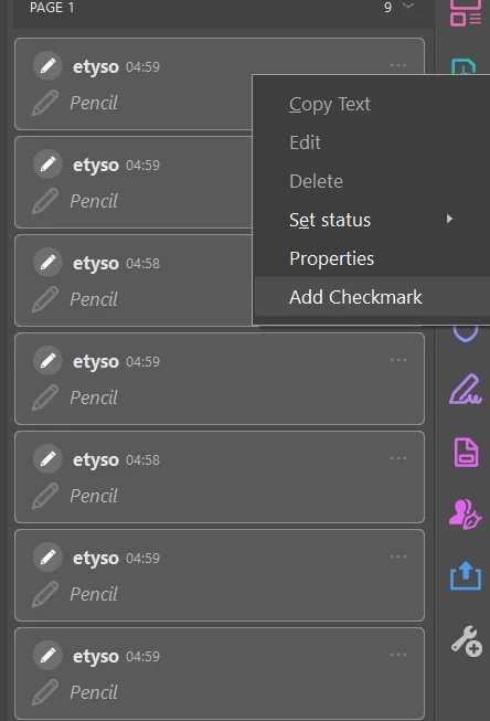

You don't have to do them 1 by 1 in the PDF
You can filter them
Select Pencil and the Colour (to rule out other marks)
Select them all
Add  a checkmark
Filter
Checked (turn off Pencil)
This will show you just the Pencil markups now (as they are checked)
Select All
Right Click
Delete
Whole process takes about 5 seconds
You can't delete if the filter for Pencil is on - so there's that - so make sure that's definitely turned off.
But as long as they are all check marks and you filter by Checked
You can then mass remove them.
Even better - ask clients to refrain from using the 'Pencil' markup.
Just say they are not imported and may not be seen - which is going to be true...
