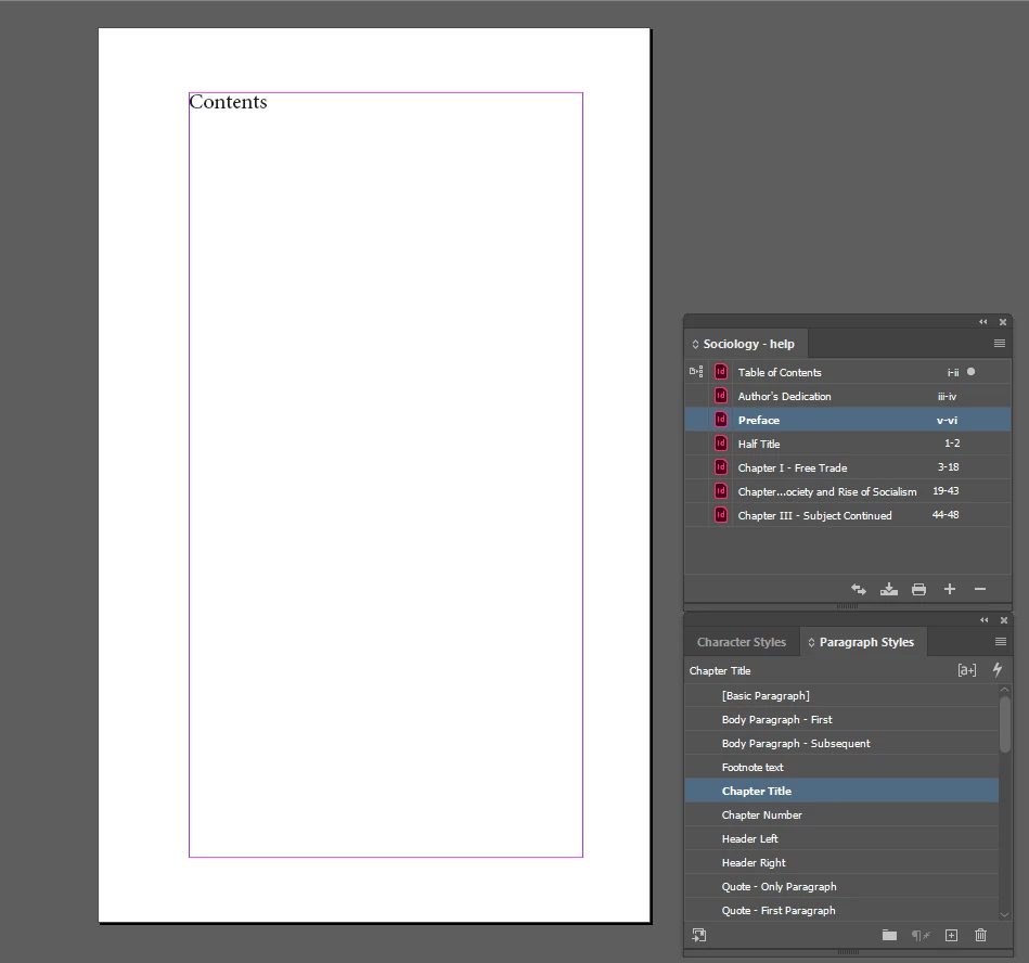

Hello, I'm trying to generate a table of contents and it's not picking up the one paragraph style I've specified. Thus, my TOC is blank. Here's what I'm doing:

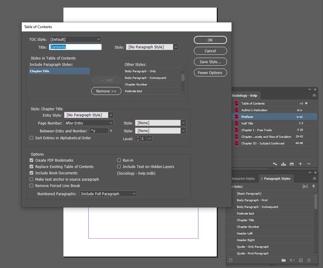

1) Open "Table of Contents" document and click Layout > Table of Contents
2) Set the table of contents as per image below and click "OK"
3) Result is shown in image below

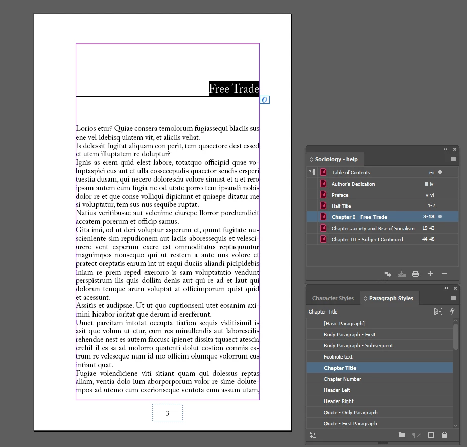

As you can see my "Table of Contents" document is my style source, and I synchronized just before trying to generate the TOC. There is no spelling discrepancy in the style name between documents. The paragraph style is in use in most of the documents, e.g. the image below:
What am I doing wrong here?

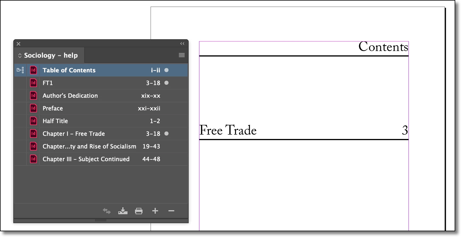

Another thing that I found in working with these files: You can make a new text box in the existing documents with that paragraph style, TOC will pick it up. Further, if you copy the text out of its existing text frame and then paste it into a new one, TOC will pick up the title. That points to the problem being somehow with the text frames, not the documents or the text itself.

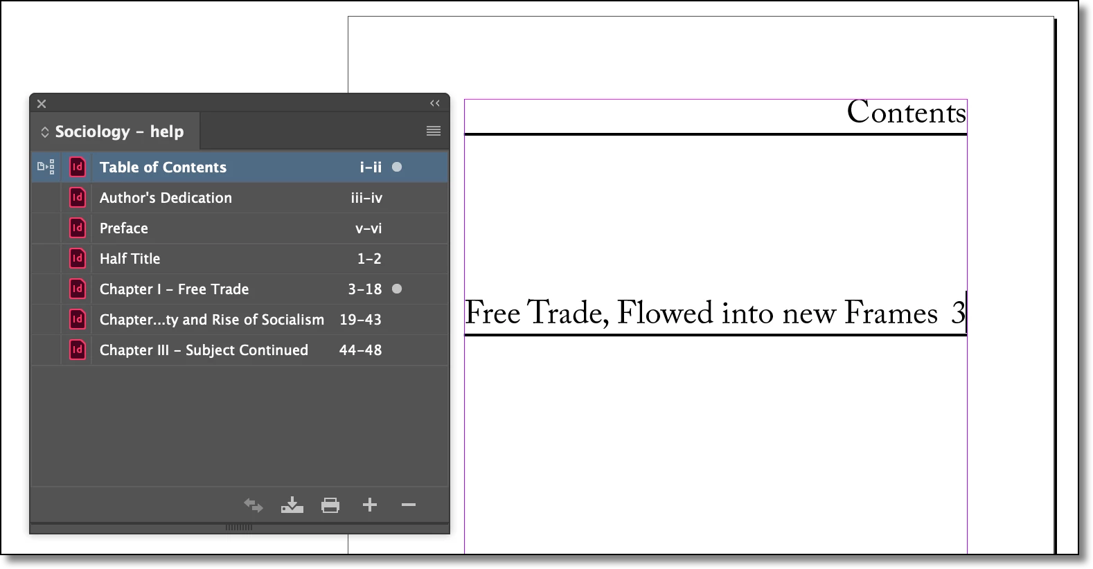

Susan is right—I selected the original free trade story, cut it, deleted all of the empty text frames and reflowed the pasted text. Bingo! We still don't know why the frames are a problem but this will be much faster than rebuilding all of the chapters.

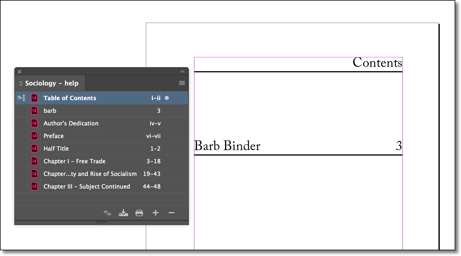

  • I made a brand new file and added it to the book, styled my name with Chapter Title and it worked as expected.
