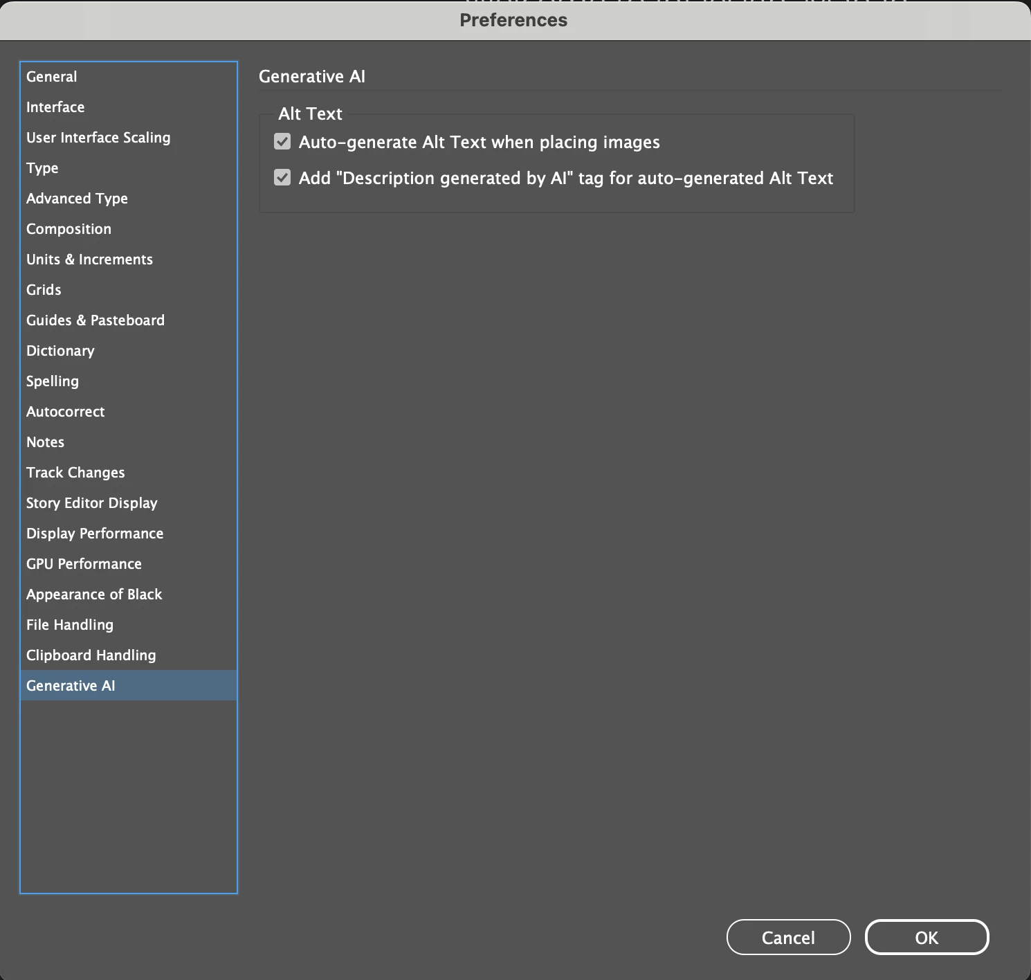

I would like to understand why the new Generative AI options for inDesign that cost credits, were on by default?
Briefly, I have ended up with an annual medical report full of hundreds of unwanted, incorrect alt texts that I have had to remove.
  • To add insult to injury, these unrequested alt texts cost credits!
  • There is no simple way to strip these out (tip: please add this feature)
  • I have had to resort to a python script to clean this document
This could have been avoided if my inDesign update had offered me this feature via an opt-in dialog.

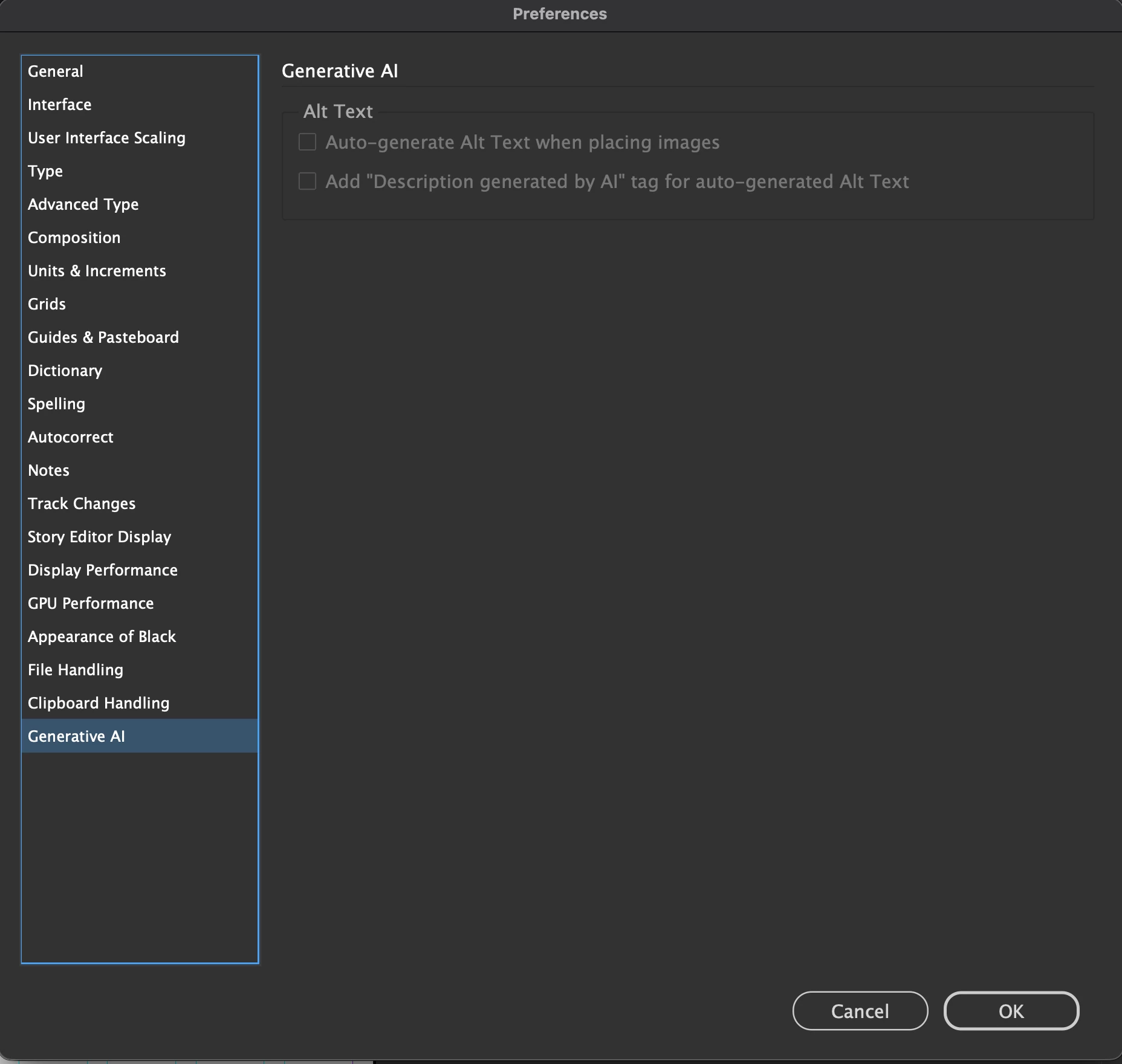

    Jul 31, 2026 9:14 AM UTC
    Please please please try to catch in your AI features again… it is NOT possible to turn it off in Preferences… it comes back again and again… and it is USELESS for me!
    Abhishek Rao
    Aug 4, 2026 4:49 PM UTC
    Hi ​@daniel_2332,
    I'm sorry to hear you're still experiencing this issue.
    Just to make sure I understand correctly, are you saying that even after turning off both options under InDesign Preferences > Generative AI, they become enabled again on their own? If so, could you please let us know when you notice them being re-enabled? For example, does it happen after restarting InDesign, opening a document, updating the application, or after performing a specific action?
    I also wanted to let you know that the broader feedback around the default behavior of the Generative AI Alt Text feature is currently being discussed internally. The team is actively reviewing community feedback and continuing to improve the experience in each release. Your observations about the preferences not remaining disabled, if that's what's happening, would be particularly valuable for that ongoing discussion.
    Looking forward to your update.
    Abhishek
    Aug 5, 2026 7:49 AM UTC
    the options are not re-enabled… generative AI are both unchecked and stay like this… its just no difference... if i copy paste a picture the alt text is still being generated… i find no way to turn it off permanently… really annoying!!!

    May 11, 2026 4:25 PM UTC
    The option to “enable/disable” these settings is unavailable for me, however I just opened up a document that previously had no alt-text at all, and it now has AI alt-text on every single picture.
    Am I correctly led to believe that this setting is generating AI alt-text and I have no way to disable it??
    Cheers

    dominico54545139
    May 11, 2026 10:52 AM UTC
    Apologies if I am committing a faux pas, but I want to clarify that this is not the answer to my question.
    I really appreciate the assistance, but I had already switched this off in my software.
    My question was why it was default “on” in the first place.
    Thank you
    May 11, 2026 12:31 PM UTC
    Because that’s the way it is was decided at management/programming decision making - it was turned on because it’s a new feature - which seems to be default for Adobe from what I can gather.
    The answer is to turn it off in the preferences until Adobe make it an opt-in only in the future.
    Sorry if it’s not the answer you’re looking for - but it is the way it is.
    I believe there’s a script to turn it off and make it is always off with a startup script
