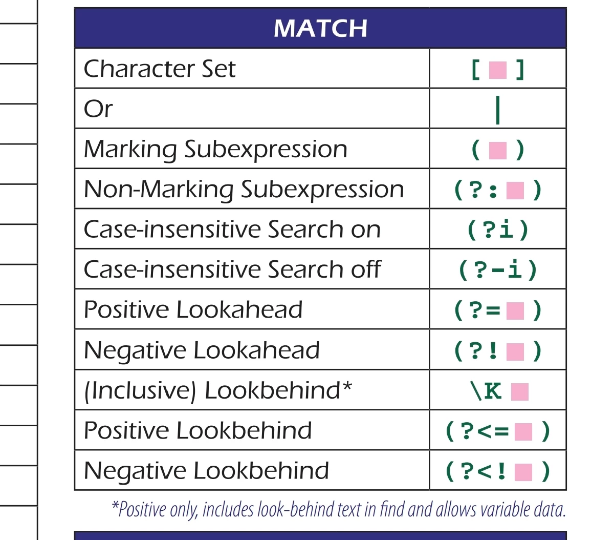

InDesign GREP chart
I've recently uploaded a GREP list/cheat sheet/reference card to a couple of topics. It's one I created a few years ago and have been updating for my own uses, since I can't seem to find one that meets all my wishes — complete, accurate, organized, reasonably tidy-looking and without the points of murky example or understanding that so many of the references out there seem to have. (Okay, I'm fussy.)
After my upload yesterday I noticed an error, and some omissions, and one thing led to another, and so — very polished version of what I think a GREP reference should be is attached. I hope both newcomers and grizzled GREPpers find it useful.
PDF and IDML also available on my digital publishing reference site.
All due credit, both in general and as a resource for this update/polishing round, to @Peter Kahrel 's authoritative GREP in InDesign.
[Older version removed; updated file in later post.]

@James Gifford—NitroPress Thanks for the chart. And although this thread has become nearly impossible to follow in any navigational way, all that back and forth discussion about \K has finally, I think, given me an understanding of the functional use for it, so thanks to all the folks who chimed in about that, too.
Mike Witherell
Feb 15, 2025 2:49 PM UTC
James, I applaud your neat and orderly layout presentation. It looks nice.
This is the way I have been describing it (\K) in my GREP code list:
Lookbehind (keep text found out of match) ............. \K
Do you think that should be rewritten for better clarity?
Mike Witherell
Feb 18, 2025 4:07 PM UTC
Okay.
(1) I changed the note for non-marking expression from * "Mostly Obsolete" to "* Obsolete" to make room for a few more words about our pal \K — there not being another millimeter for text on this sheet. I settled on Mostly Obsolete after the last disucssion in which it was explained to me that 'non marking' means it doesn's use up system memory over execution, which can be, or was, important in systems with small working memory.. Since pretty much all systems have vast-to-unlimited memory these days, I suppose some massive GREP string might benefit from this efficiency twist, but my thought is anyone writing such huge search strings already knows that. So I'm changing that to "*Rarely needed in place of regular Subexpression."
(2) I find it amusing/vexing/frustrating that there is hardly ANY authoritative info on our pal \K... searches turn up little but brief notes and/or endless discussion/argument, most of which are written in pure gibberish. It isn't even included on some majority of references/charts. Were I not a compleatist, I'd just delete the whole line and be done with it; this sheet is meant for beginners to occasional GREPpers, not those who think in terms of combined lookbehind/lookahead structure. So to make the chart compleat, avoid looking like a compleat idiot to GREP-fu Masters, and make use of the limited space, I'm naming it Reset Match and making the note "†Complicated geekahol."
The IDML version is all yours for further, personal, deeply meaningful edits. 🙂
Peter Kahrel
Feb 18, 2025 4:35 PM UTC
If it was just about memory then I'd agree with you that there's not much need for non-marking expressions. But it's not only about memory, it's about speed as well. For the occasional GREP expression it's not going to make much difference. But if you stuff your document with GREP styles and use a lot of grouping -- expressions enclosed in parentheses -- it will certainly make a difference.
James -- Just one small comment on your excellent chart: in the Character-class box the label for \x{■} says "Hex Code (2 or 4 digit)", but that can be 1- or 3-digit too. You can omit leading zeros: \x{9} finds tab characters, \x{14b}, the eng. It's no big deal, but maybe say '1-4 digits'.
P.
Feb 15, 2025 4:07 PM UTC
Noted, thanks. I will probably do an update once all the dust settles here... but (re the \K thing) I did mean this to be a quickref chart and not a full annotated distillation of your book. 🙂

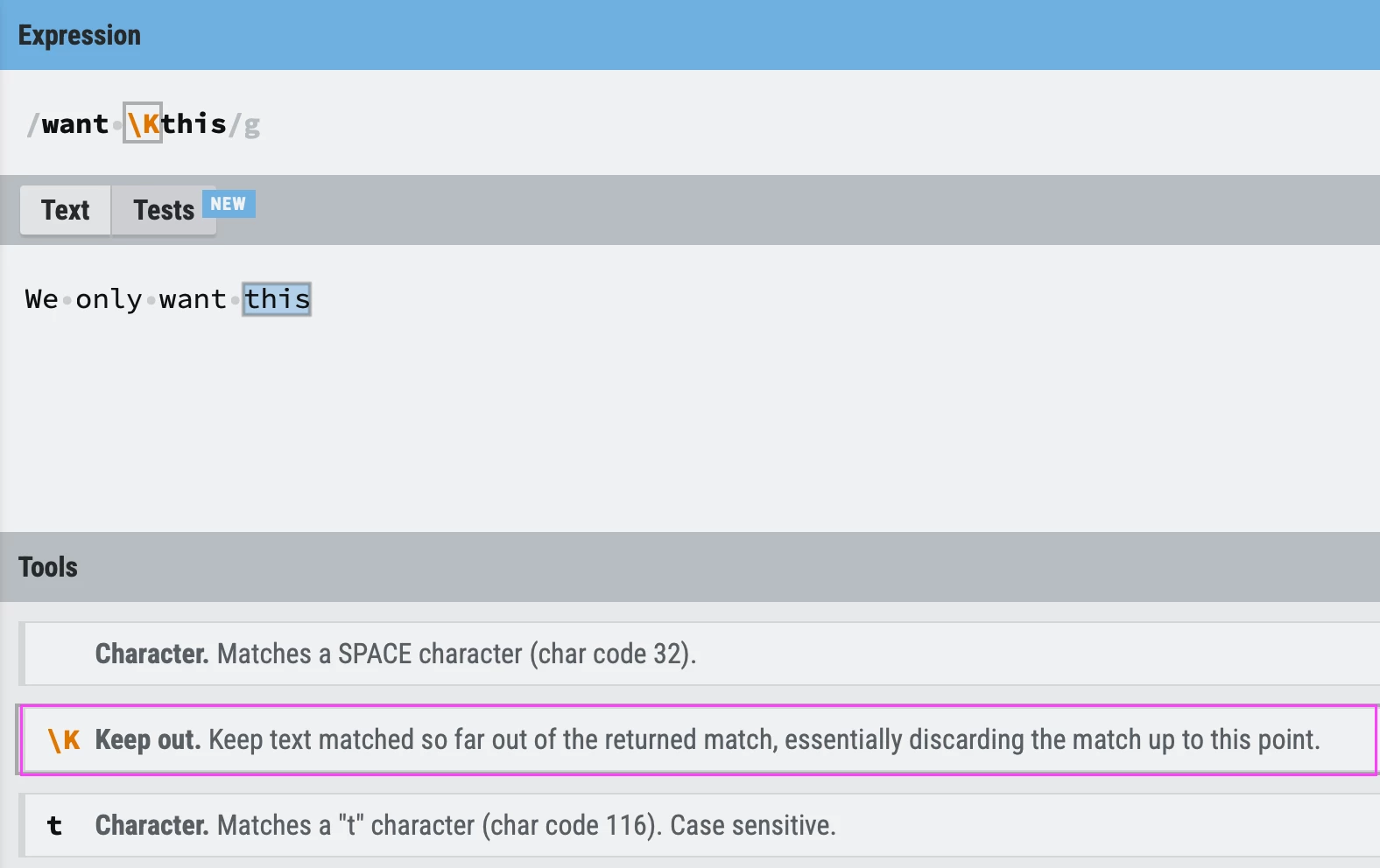

Hi @James Gifford—NitroPress, thanks for posting this. I think it's great!
I'd make one observation: that the explanation for \K is surprisingly difficult to understand for me. A clearer description, in my opinion, would be "Reset Match" or something like that. The K is usually referred to as "keep out" but that doesn't help my mental model because what it actually does is discard the current match and start again. In fact "discard" might be a good word to use. Anyway, with that in mind, the explanation via the asterisk is quite opaque, at least to me.
Otherwise, thanks for sharing.

m1b
Feb 15, 2025 1:50 PM UTC
Yes Robert, I'm talking about \K. The first two links you posted give wrong information. It is not a "lookbehind" of any kind. The third post was correct.
But here's a more straightforward explanation, from regexr.com (my highlight in magenta rectangle):
- Mark
