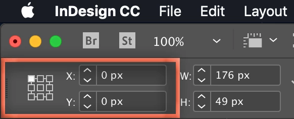

Hi Justin:
You can right click each of the rulers to change them to pixels (or just change the units to pixels in Preferences > Units & Increments). Then select an object and the width and height will be displayed as pixels.

Ah, thanks for clarifying.
InDesign can display the X and Y offsets from the reference point in the proxy (distance from the zero point‚ normally the top left of the paper but can be customized) but it is not a tool that is normally used for web page design or app design, so no there is no equivalent feature.
If you are going to use InDesign for this and find the Measure tool too slow, see if moving the zero point is helpful. Drag the cross hairs to a new location on the page. Double click them to reset to their original positions. I think you'd be better off in a different application.
