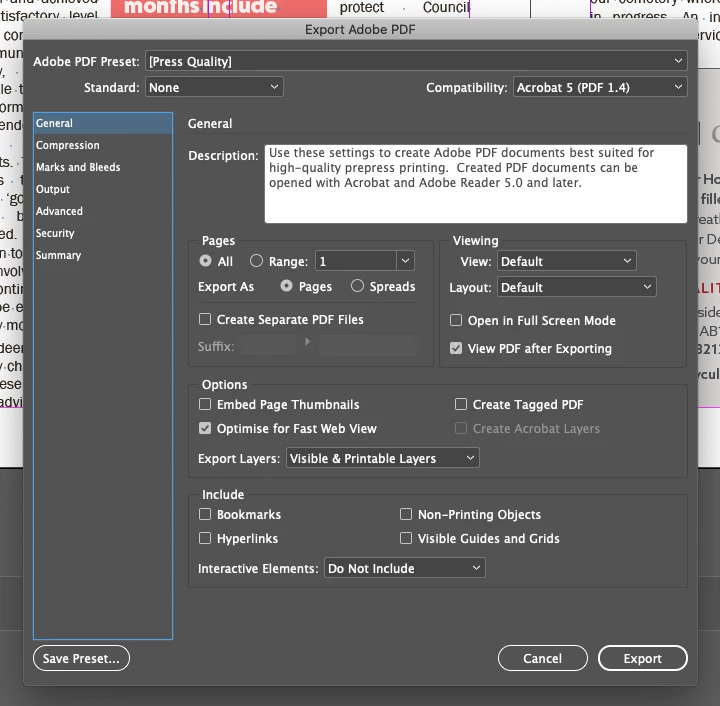

I've searched the InDesign forum but can't seem to find a solution to my issue.  When I copy and paste or even manually type in a hyperlink address which spans over two lines - when converted to PDF it breaks at the end of the first line.
I've enabled "Show Hidden Characters" and there's no breaks showing. I've set to [No Language] and this hasn't resolved the issue.  I could set the character style to "No Breaks" but as the column text is wrapped around pull out text and inside a box it jumps to the line where the pull out text/box finishes. I also have hypenate disabled.
I'm also on the latest version of InDesign 2020 - 15.1.1
Attached is a PDF of the page I'm having an issue with. Any feedback would be much appreciated, thank you.
Kind regards
Barry
Correct answer Mike Witherell
Your screen shows press quality *without* include Hyperlinks.
What happens if you ...
Turn that switch on
or
Export to Interactive PDF?

Mike Witherell
July 16, 2020
What recipe preset are you using for exporting the PDF?

I've set to Press Quality - default settings.  Thank you

Mike Witherell
July 16, 2020
So, in other words, when you look at the Hyperlink Options, you see the whole URL spelled correctly and not truncated, correct?
