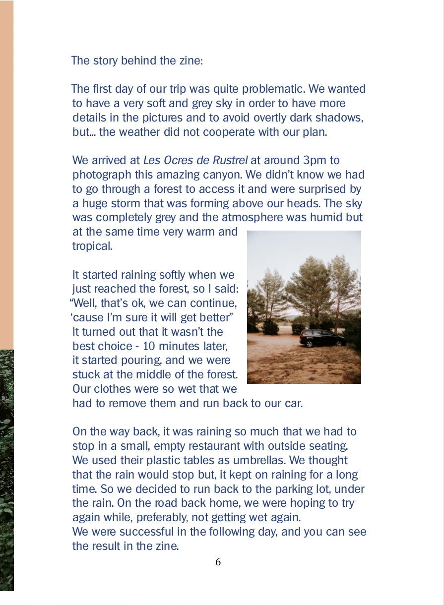

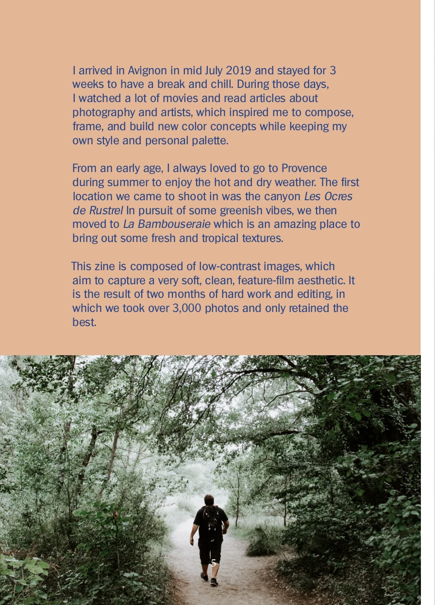

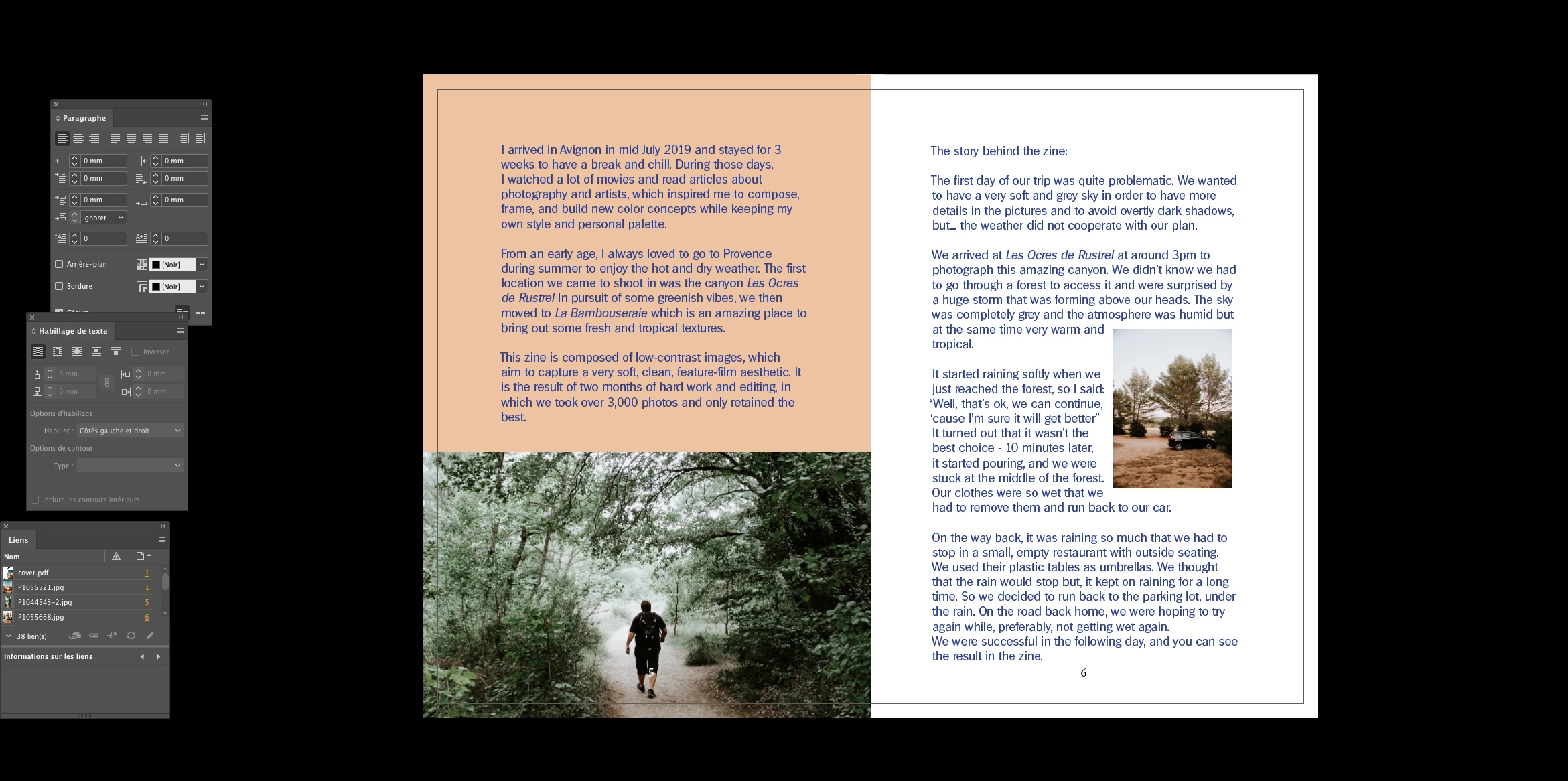

Hello there,
I have recently finished a photography book and I'm having a lot of trouble with a page and bleed space.
When I open the file, it is cut, in the borders in the middle, the content of page 5 is on page 6, and page 6 on page 5...
What is happening with my file?
Thanks.

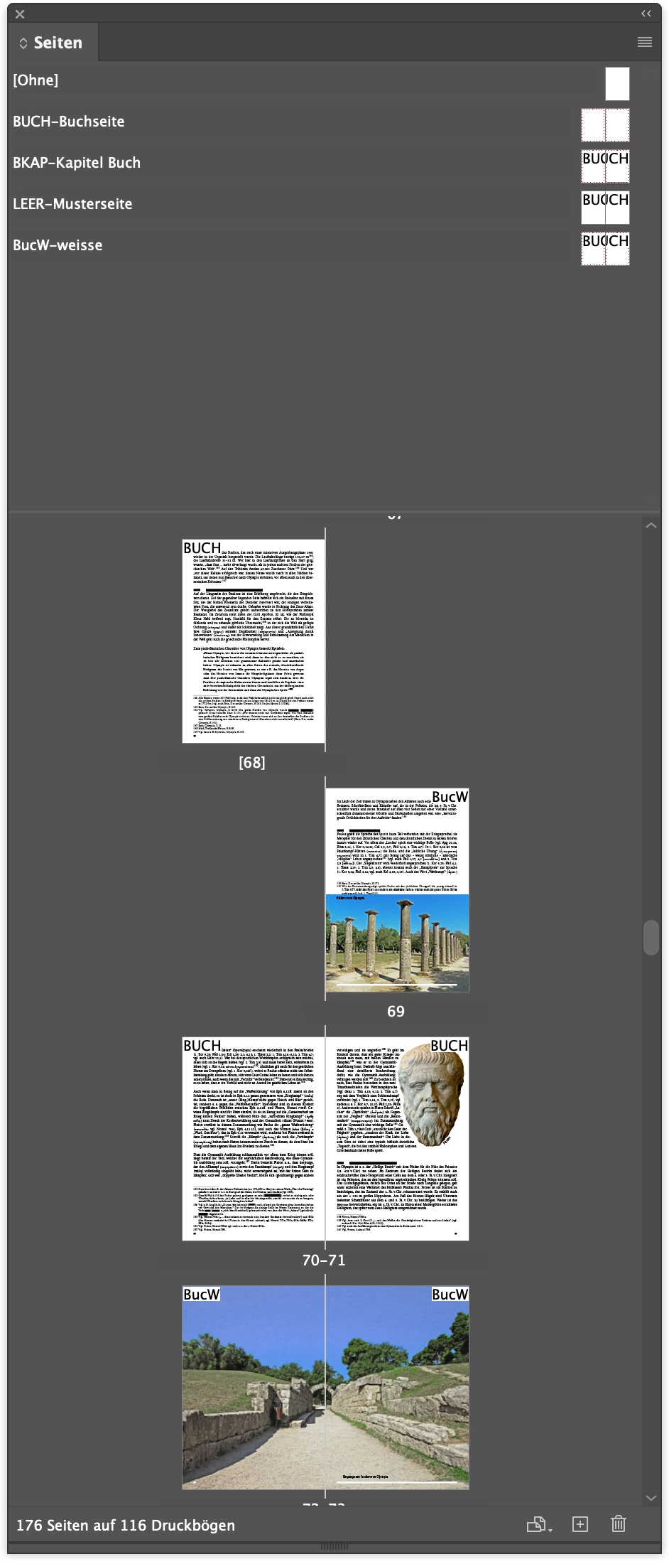

Correct answer Willi Adelberger
  1. Open Window > Pages Panel
  2. Select the specific spread you need to seperate by clicking twice on the page numbers below the thumbnails in the Pages Panel.
  3. In the Pages Panel Menu deselect the option to Allow to Shuffle Pages.
  4. Klick twice on one of the thumbnails of that spread to select the page.
  5. Drag that thmbnail to aside until you sea a vertical bar, Release it.

Willi Adelberger
Willi AdelbergerCommunity ExpertCorrect answer
January 8, 2020

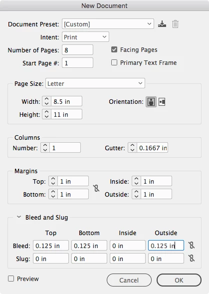

rob day
January 7, 2020
Set the Inside Bleed to 0. Most common binding methods don’t require inside bleeds. The inside spine edge is folded not trimmed. If you provide a bleed it would get removed when the pages are imposed by the printer.
January 8, 2020
how do I change the inside bleed?
rob day

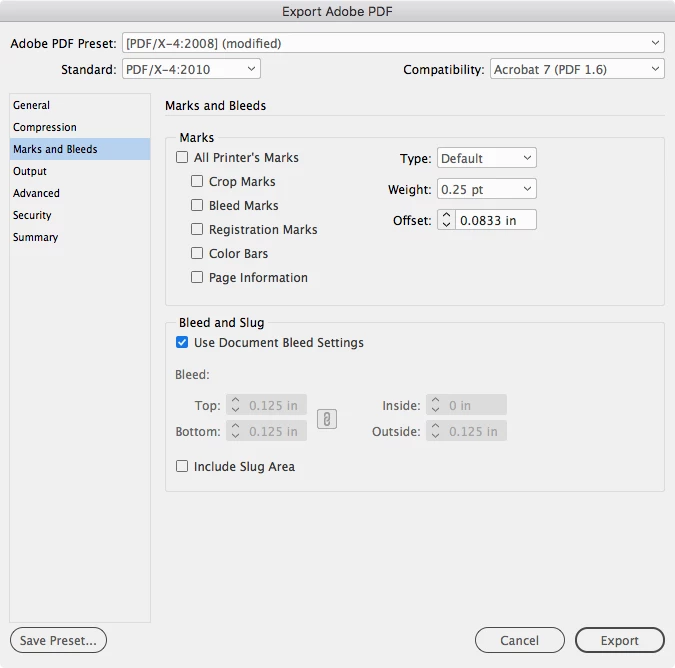

January 9, 2020
From the document setup:
And when you export Use Document Bleed Settings:
dave c courtemanche
January 7, 2020
Is your doc set up as facing pages? It looks like you're bleeding on the inside of the page, which is what you need if the printer wants bleeds. Typically that's cut off, so you shouldn't need to worry.
