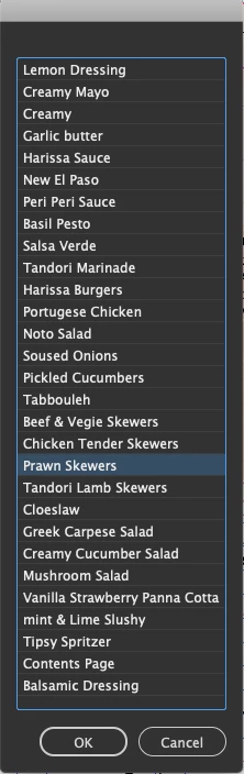

2. The script will display a list of all of the available Hyperlink Text Destinations where the users will select one and the result will be saved into a variable.
