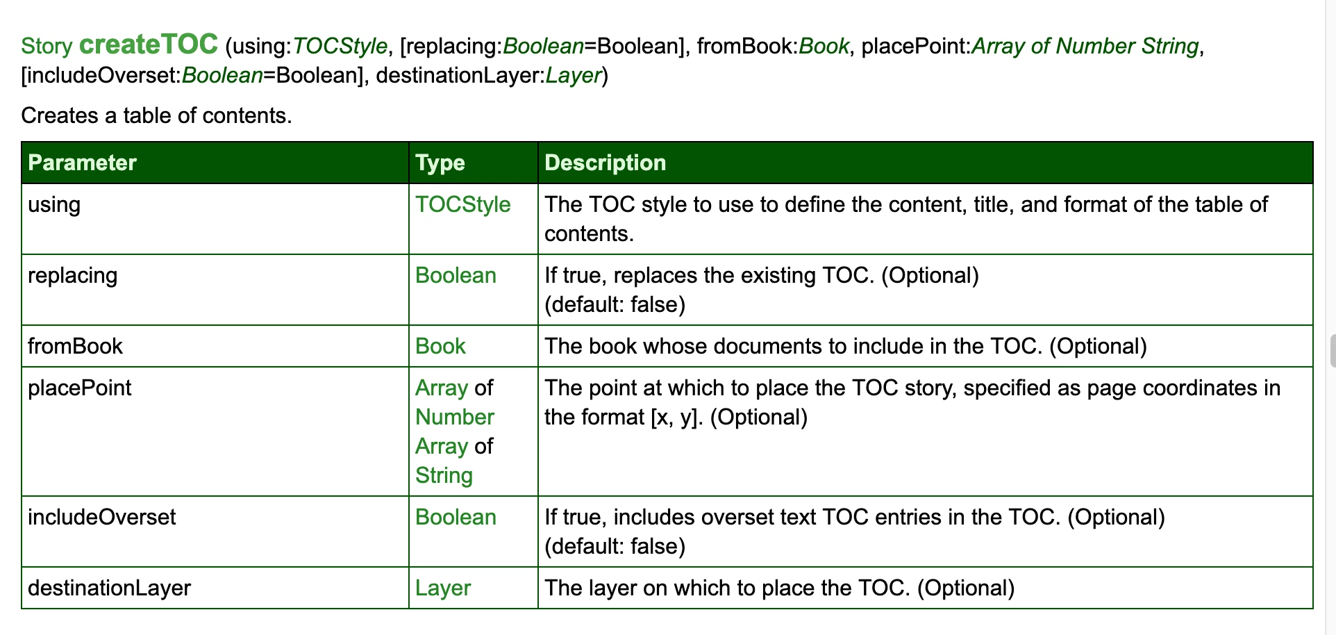

rob day
Jan 28, 2026 2:13 PM UTC
Hi ​@Jurre37971467hccf , Here is a capture from the document’s createTOC() method—the 2nd parameter is a replace boolean
