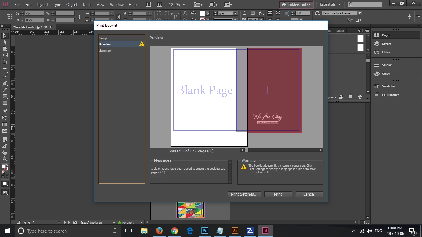

Hi everyone! I have a 28-page booklet, and everytime I create it, InDesign adds an extra to the front. 28 divide 4 is 7...so it is fine. So why??? I just noticed it says 12 pages that it's printing, when it should be more. I also noticed that when I click forward to see the pages, all the blank pages I have are missing. However, I clicked on Print Blank Printer Spreads, but that doesn't seem to fix things.

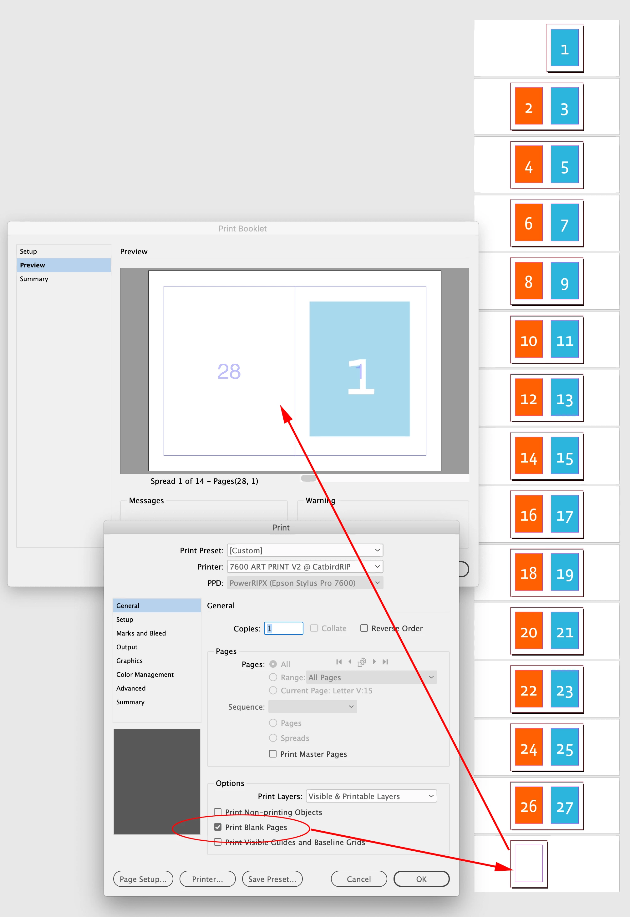

@katherinev7222705 ’s document has 28 pages (7, 4 page signatures), so Print Booklet will impose it without adding blank pages as long as Print Blank Pages is checked in the Print dialog:

October 7, 2017
You have to click on Print Settings.... and make sure print blank pages is included there.

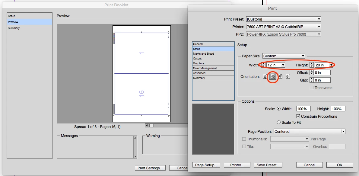

You also have to use Print Settings to setup the paper size and orientation, your setup won't work because the printer spread isn't fitting on the smaller paper size and that's why you are getting the yellow warning triangle in the booklet dialog.
The paper size has to be large enough to hold the printer spread
