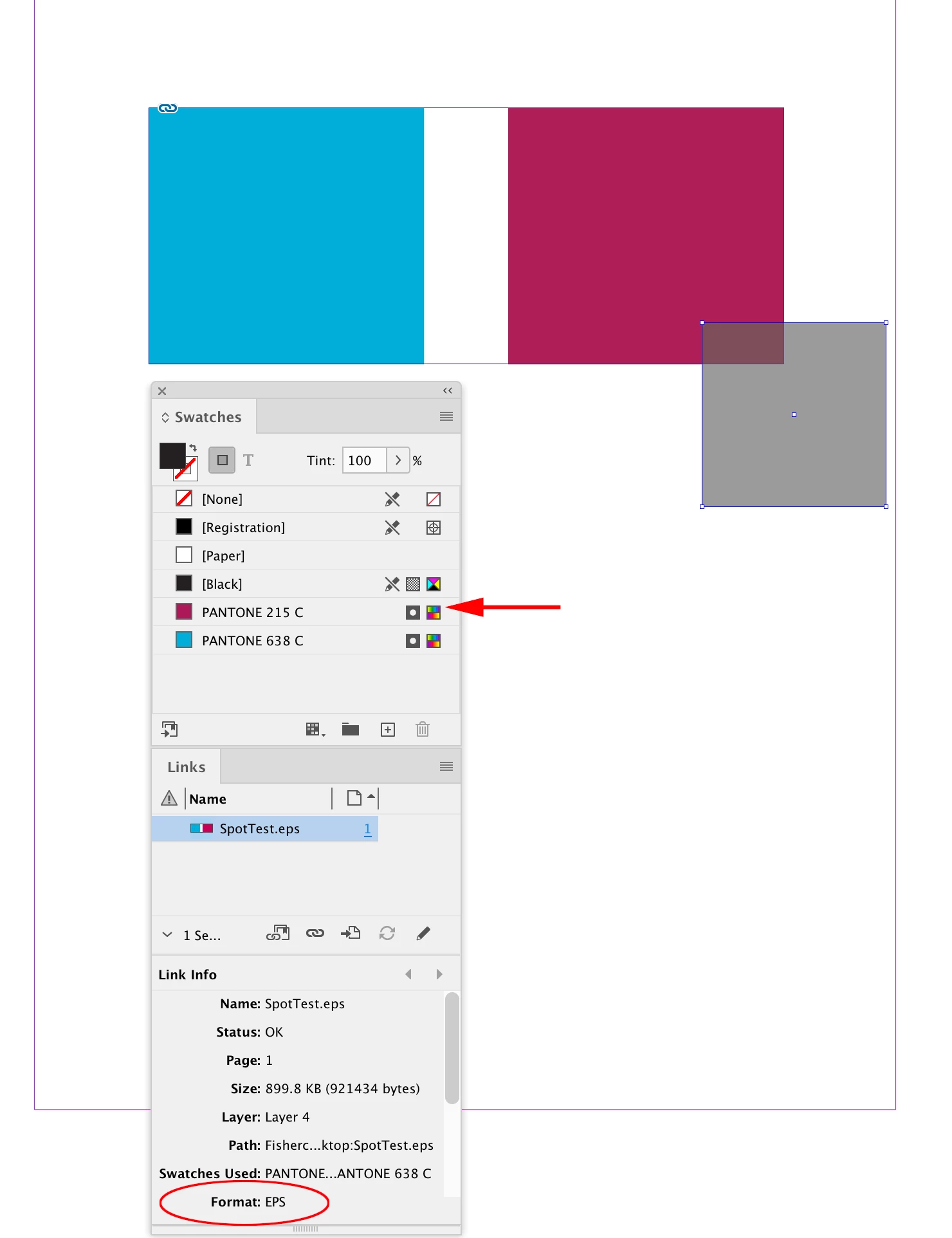

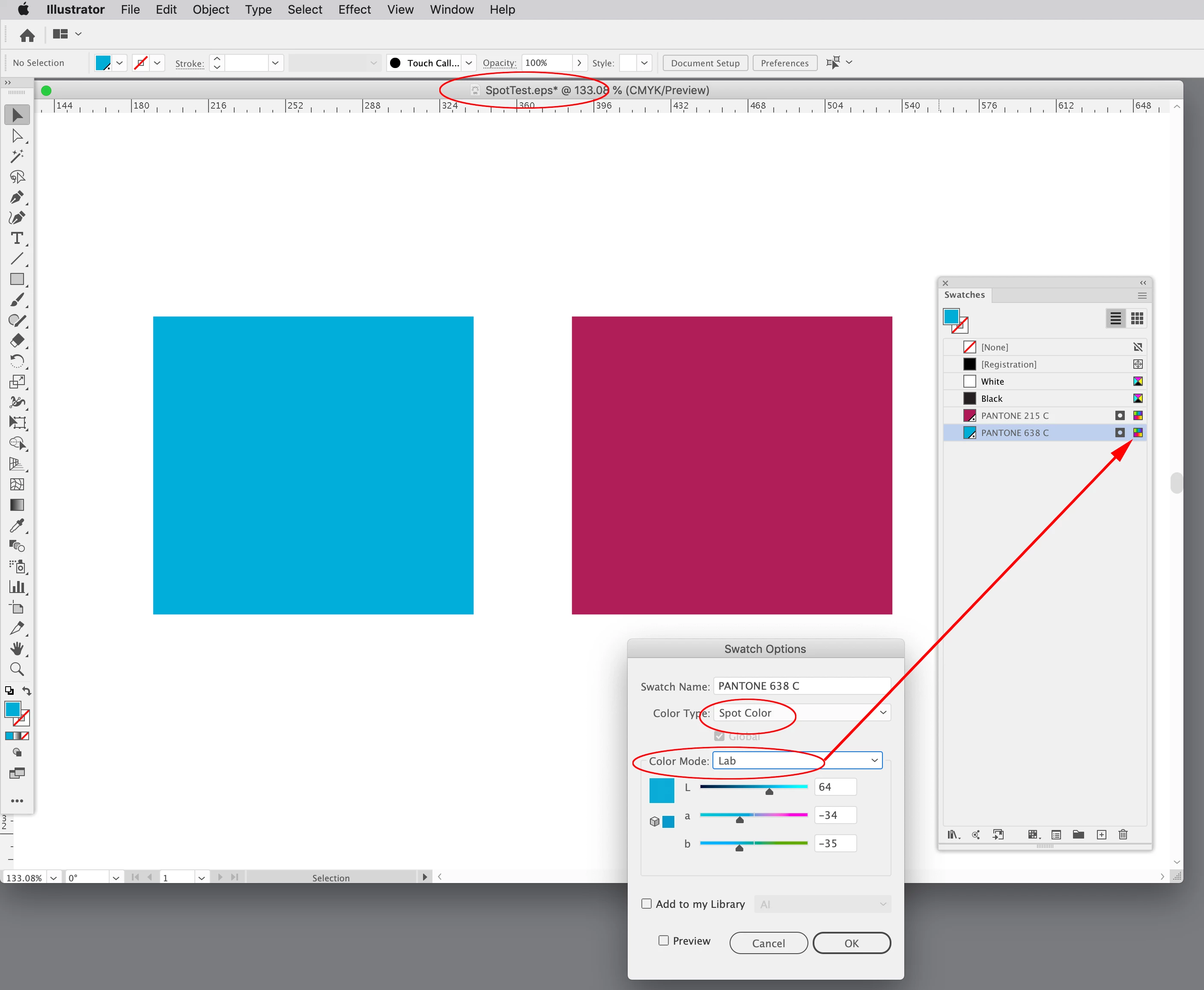

Hi @TenWest Creative , Also, if you are using Spot colors and the screen preview accuracy matters to you, set the Color Mode of the Spot Color to Lab not CMYK. The Spot color libraries in InDesign in Illustrator were set to Lab starting with CS6:
