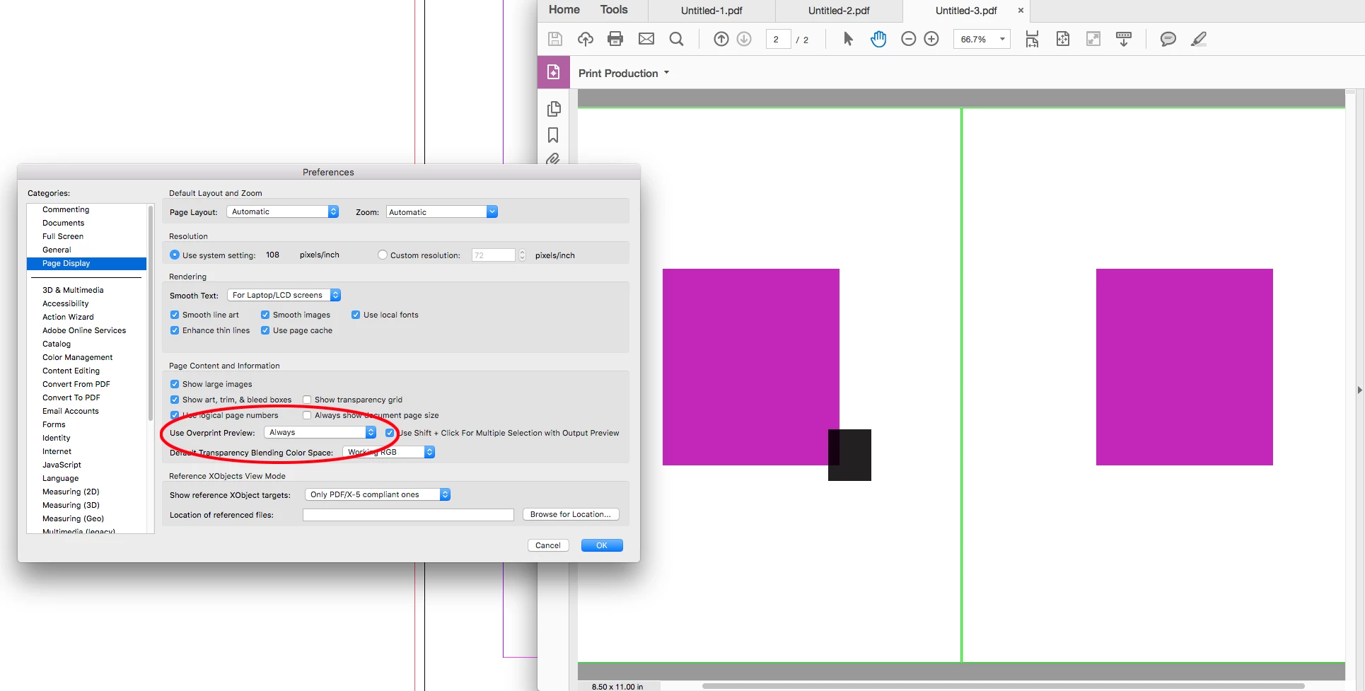

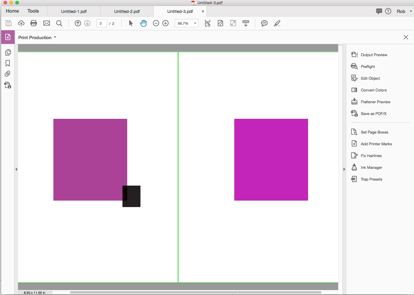

If you have any transparency on the page the Overprint Setting in both ID and Acrobat will affect the spot color display, even when you export as PDF/X-4 as Bob suggests.
So here I have PANTONE Purple on a page with transparency and on a page without. In Acrobat Reader or Pro, make sure your Overprint preference is set to Always:
Here I have my Use Overprint Preview pref set to Never.
Set to Always.

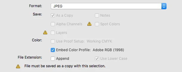

You can't use spot colors with jpegs or png images. To use a true spot color with an image you would have to use an extra Spot Channel and save in a format that supports Spot Channels:
Alternatively you can save flattened grayscales and apply a spot color in InDesign. Or you can use Pantone's Bridge Libraries which are process CMYK colors and could be applied to a CMYK JPEG, but not a PNG, which can't be CMYK.
