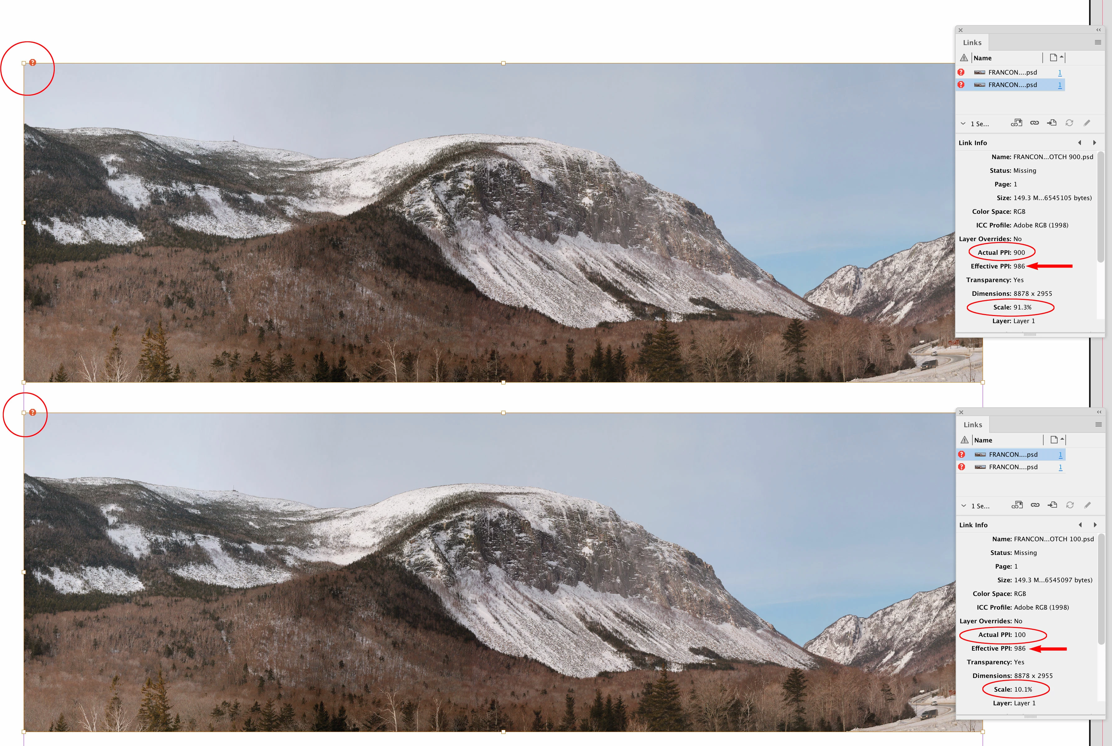

Hi @bunnika , It would take some planning, but you can manipulate the resolution of missing link proxies via scaling—the lower the scale value the higher the proxy resolution will be when the links are missing.
For example, here I’ve duplicated and placed the same file with identical pixel dimensions, but different Actual Resolutions, then trashed the originals. On the page I have scaled them to the same dimensions, so their Effective Resolutions—the final output resolution— match at 383PPI. The bottom image was scaled to 10%, so its proxy resolution is much higher than the top version, which is scaled to 91%:

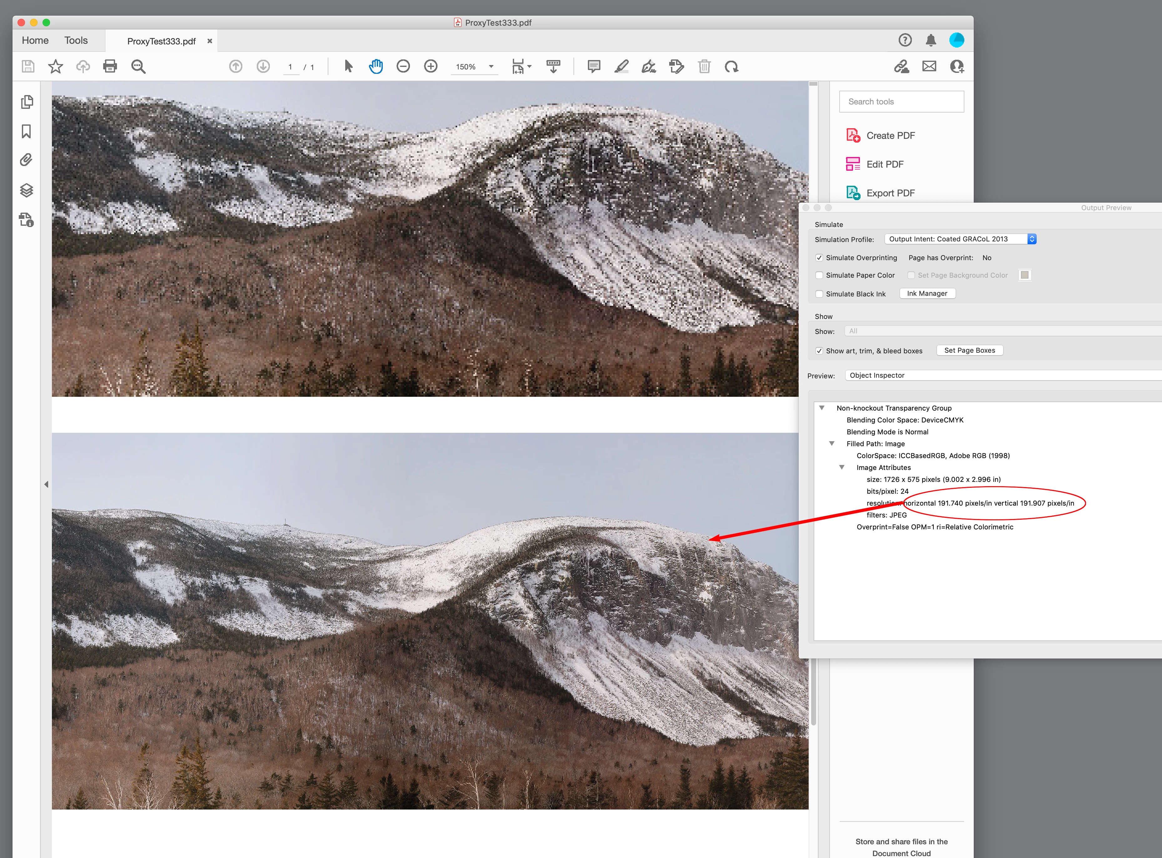

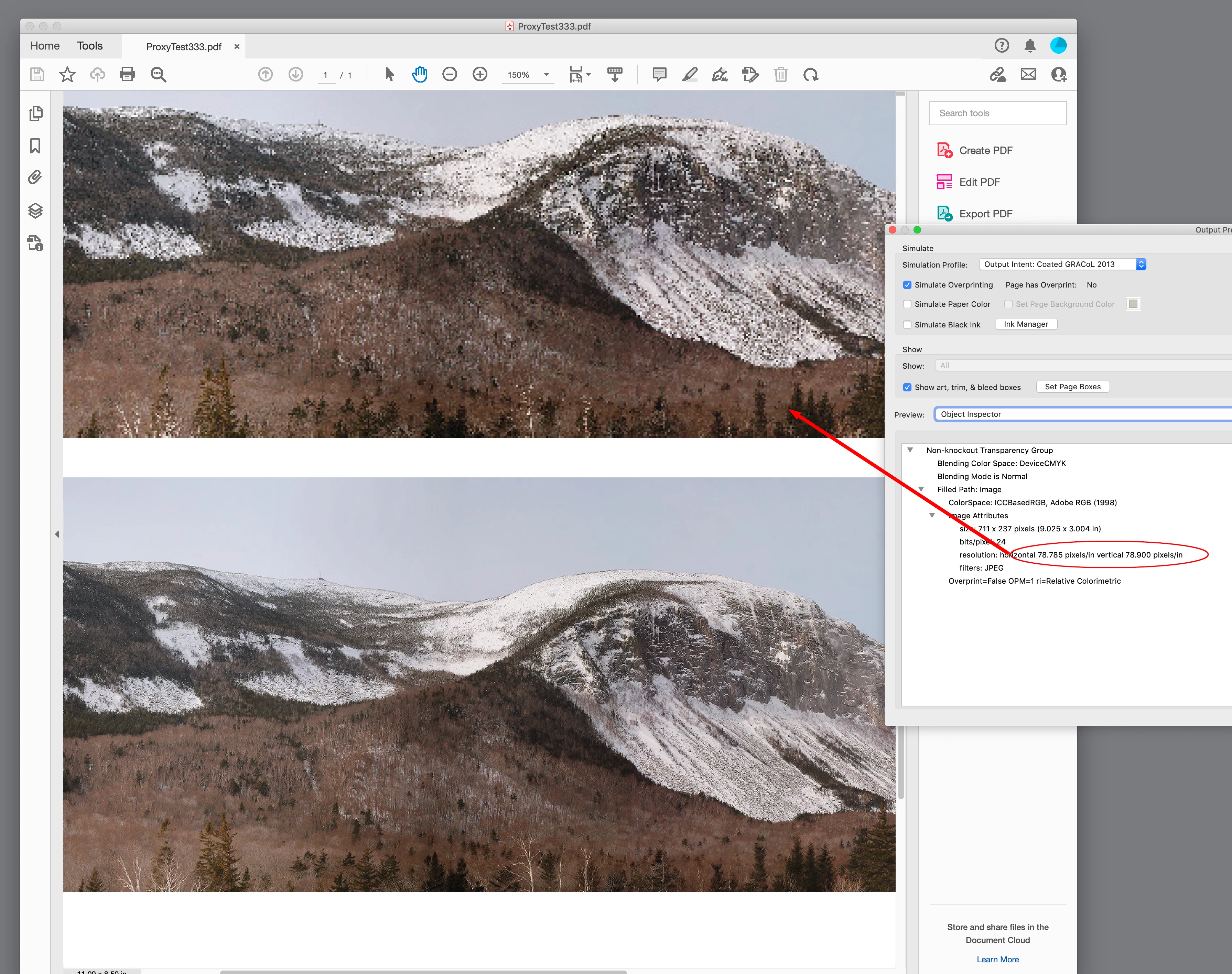

When I Export to the default PDF/X-4 preset the top image inspects at 78ppi, and the bottom image that has been scaled to 10% inspects at 191ppi. If the links were not missing, both images would inspect at 383ppi
