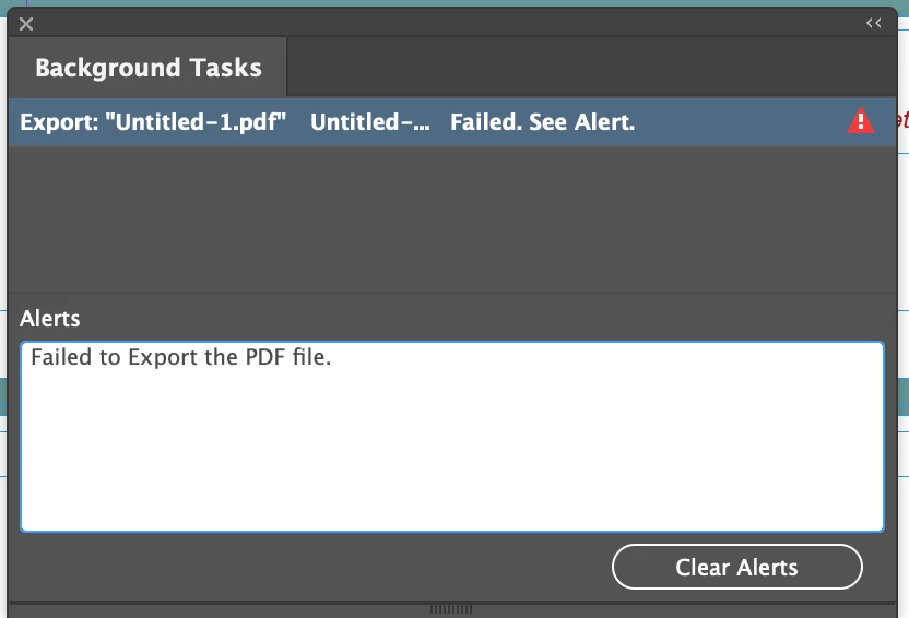

Hi everyone,
Of course this is time-sensitive...I've exported hundreds of documents over the years and now have an extinction-level event occuring.
It just won't export.  At first, it was just getting hung up in exporting (no spinning circle, which was a red flag)...the file was just Zero Bytes forever.
So took a look at troubleshooting and found it might be the file so I created a new one and copy & pasted a page to it and it exported.  Thought I'd just C&P everything to the new one but when I added 2 more pages it had the same error - the message is "PDF export Failed" (thanks...) Also, the pages I C&Ped over lost some of the graphics, which was weird.  I've had unlinked images many times and pages exported anyways.

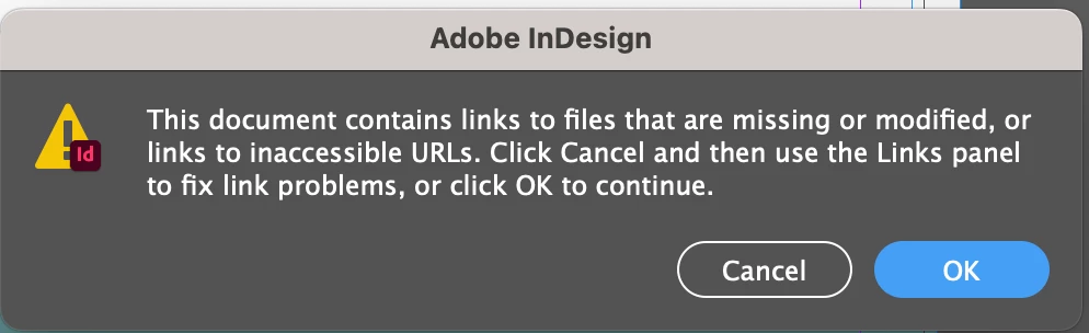

So I created a new doc with the C&P of one page and ensured that all of the links were good.  Same error (export failed).
I rebooted my Mac.  Same error.
I uninstalled InDesign, rebooted, re-installed...same error.
The one page that did export earlier seems to be an outlier, as doing the same thing later has the same failed export problem.
Sort of have to get this out for proofing/approval today.  Any ideas?
