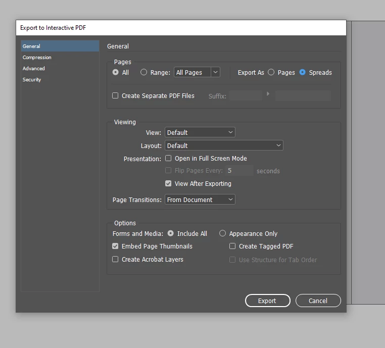

Hi all,
I have a document set up as pages that I am trying to export to spreads, but it will only export to pages even though I have selected "spreads" in the export dialogue box.
I have cleared my presets and loaded a custom preset. I have even tried printing to pdf, however the same issue still happens.
The only way I can get it to work is with the two-up option selected which I would prefer not to use as it exprots with the grey separator line down the middle; I just want a clean continuous spread.
This seems to coinside with the latest update. Is anyone else experiencing this problem and has anyone found a solution?
Thank you
Correct answer jforsyth
You've inadvertently solved my problem! I took a second glance at my page attributes. I have custom page numbering I hadn't unticked the "Allow Shuffle" once I fixed this up, it exported fine.

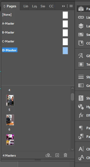

Willi Adelberger
May 7, 2020
Can you show us a creen shot of the page panel?
jforsythAuthor
May 11, 2020
