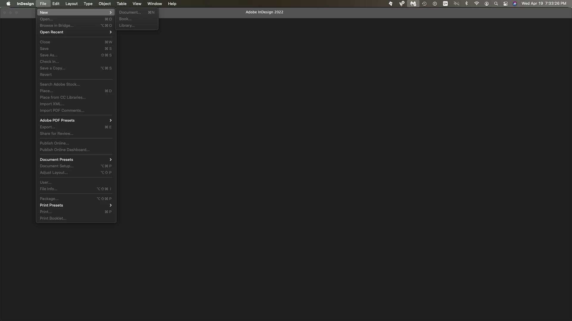

April 19, 2023
Thank you, Rishabh. I was able to find the file, and I made the suggested change to the plist filename, but that didn't fix the issue (I also restarted my Mac, but that didn't help). I've got InDesign2022 on Mac Big Sur (I'm not sure there's a more recent version for InDesign; I used to have a button in my menu bar that showed when I was connected to Creative Cloud, but that's gone, and there's no launcher in my Adobe Applications directory). I'm attaching a screenshot of what I see (dark mode)--a GUI with a top menu, but then, when I attempt to use a dropdown to (for example) create a new document, the option is grayed out (and there's no spinning vortex of doom or any other sign of the app performing any function).
