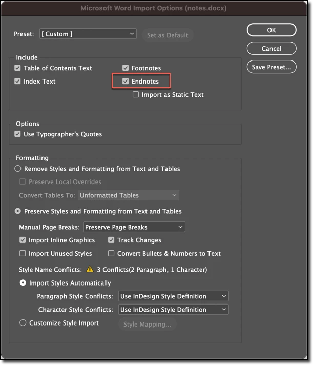

Barb Binder
May 24, 2023
Hi @Herbiedriver1:
Did you enable Show Import Options at the bottom of the File > Place dialog box, and enable Include Endnotes? I have not had any issues with this workflow placing a .docx file created in Word 365. They convert as expected.
~Barb
