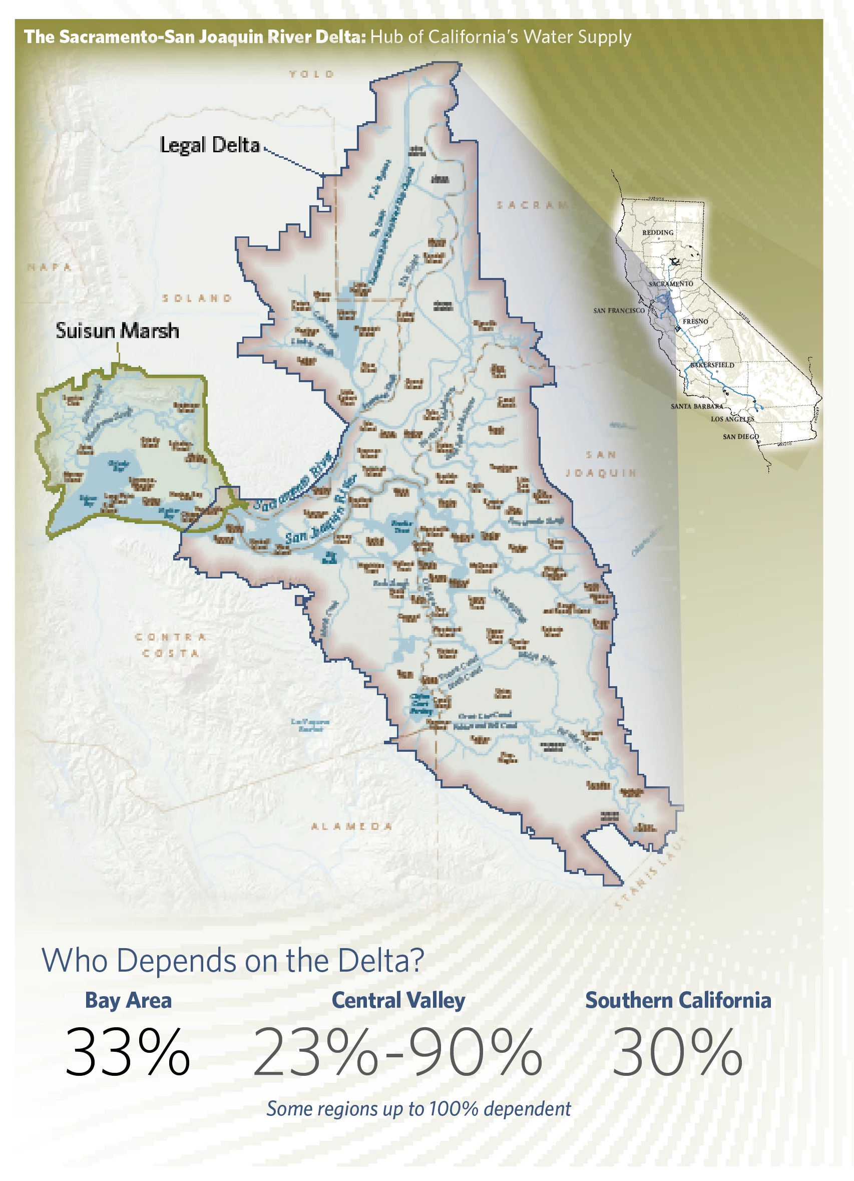

I have a completed ID document that is having an issue: this page gives me the beachball - I can save out an .idml, but ID crashes when I do it, and when I reopen, it goes to beachball. This is ID 2015 CC on a late-model iMac.
Each item except the two fades are links. I have tried moving the links: no difference, even though I got the relink alert; I have tried not updating and updating.
Any suggestions or fixes available? On a bit of a deadline here … 36 page document.
Problem started when I set the color type at the bottom to Multiply - was specing the type with the Eyedropper and FOOM - beachball attack.

    Two suggestions—standard troubleshooting:
    (1) Save your InDesign file as an IDML to deal with corruption:
    Clean corrupt files by exporting to .IDML or .INX
    (2) Restore your InDesign preferences:
    Trash, Replace, Reset, or Restore the application Preferences
    January 12, 2017
    did both of these - sadly no improvement …

    Does it happen with files other than the one you posted about?
