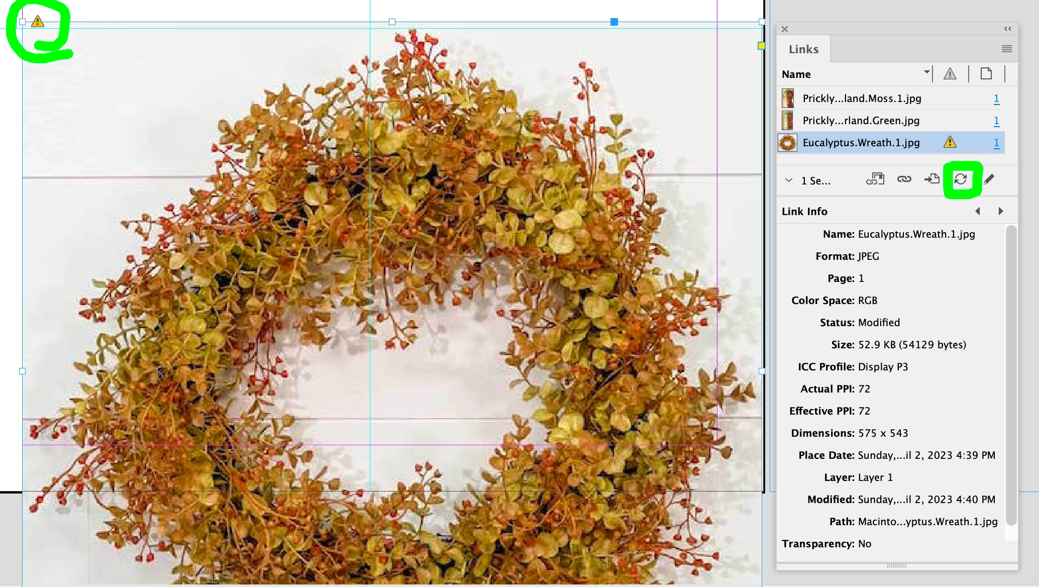

I "place" a jpg into my document, and then realize it is too large, so I go back to the original Preview jpg file and scale it down. When I return to my Indesign document I see the standard "warning" triangle next to my jpg in the links panel and double click on it. The triangle disappears, but the photo remains the same size that it was before I resized it in Preview. Nothing has changed other than the triangle disappearing.
This forces me to delete the current photo in indesign and to re-import it. I am using Indesign 18.2.1 Mac Ventura 13.2.1. Please help, Thank you!

    About your triangle problem - if you are in preview mode - you are looking at a low resolution preview of your placed image - and after you update your link in the InDesign you may not notice any changes as you are still looking at a low resolution preview.
    Beside, if you have your image as 300dpi - you won't see a change even in a HiRes preview if it's 1"x1" on a A4 page...

    Although it won't change visibly, because it is the same physical layout size, you might want to look at Link Info and/or the Info panel before and after updating the link. You will see the difference between Effective PPI resolution as laid out and scaled in InDesign versus Actual PPI resolution as Photoshop (er, Preview) made it to be.

    FYI. When InDesign updates images, it uses the existing bounding box for reference, so, any modified image will fill that same space, no matter how you resize them in PS.
    If you are consistently placing images by just "click-dropping" them, they use the internal resolution of the image and place then at 100%. So if your image has a defined resolution of 72ppi, it will cover a larger area on the page than if it had been saved as 300ppi. Alternatively, drag-drop them (ie. drag a rectangle of the approximate size you want it on the page).

    "why when I click on yellow triangle does Indesign act like its taken care of the problem (triangle disappears) but nothing else has changed?"
    Read my reply again. Yes, it did change. It DID update the file in your ID doc. The new file just filled the existing dimensions of the old one. Whether you reduced the filesize of your picture, say your existing picture was, say 8" x 10" before... your new reduced file will replace that and fill 8" x 10", yet it will be a lower resolution image. If you look at your Links panel before and after, you will see the difference in ppi.

    "This forces me to delete the current photo in indesign and to re-import it."
    You don't need to.
    Either click on the Alert symbol on the image or click the Update button in the panel.

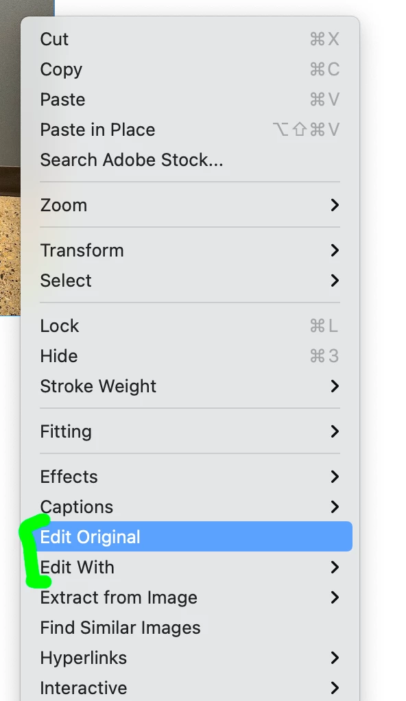

    BTW: InDesign will auto-update images that are edited by invoking the "Edit Original" or "Edit with..." by right-clicking on the image.
    However, if you edit a file completely outside InDesign (e.g. opening the file in Photoshop from the Finder/Explorer), InDesign will NOT auto-update the image. This is a safety mechanism to alert you to the fact that an asset has been modified.
