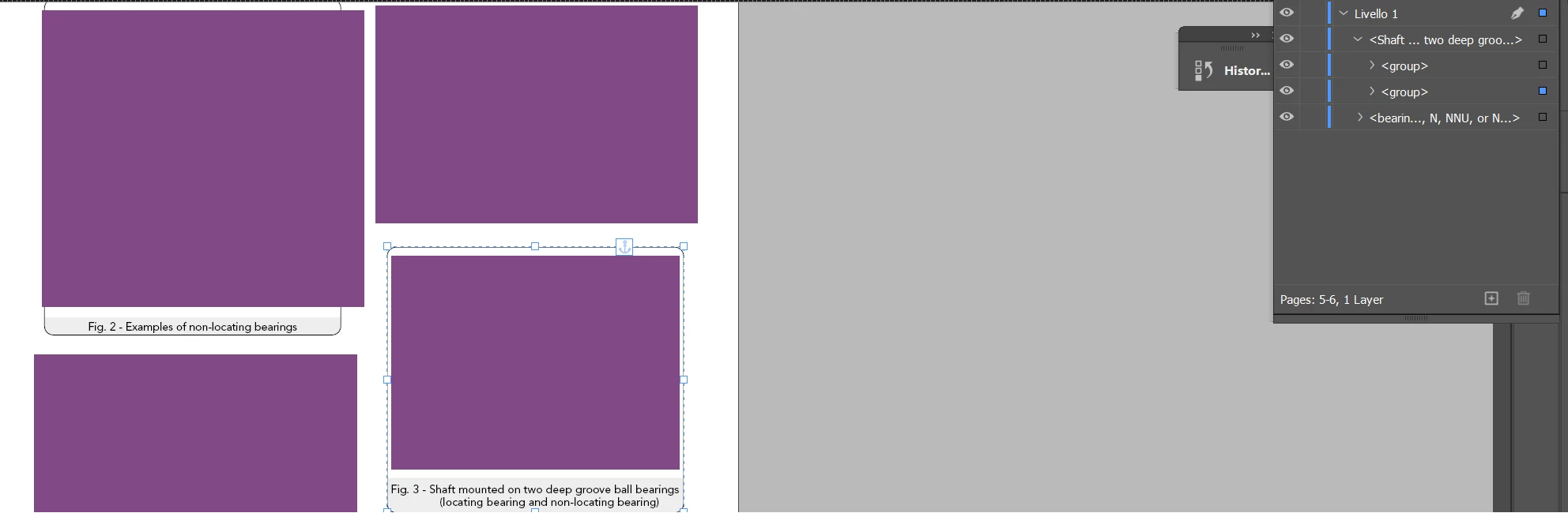

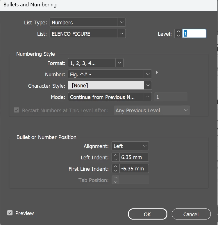

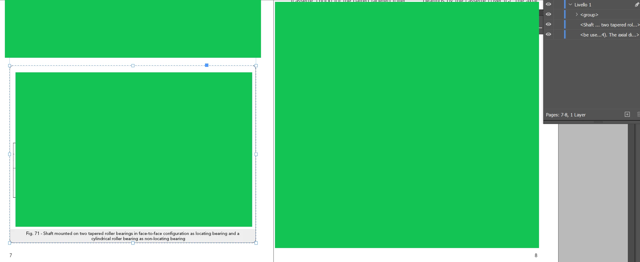

Hi, in InDesign I have a numbering list with the Mode "Continue from Previous Number" but when I try to copy paste one figure, it goes at the last number. For example if I copy one figure between 3 and 4 the new figure does not take 4th place, but goes 71 ( last number in the numbering list) what is the issue?
Note:
1. For the new elements I tried to "Restart Numbering" - but the number goes to 1, and the other elements from the list are not updated.
2. Also when I try and press "Continue Numbering" the number goes again to 71
Looking forward for a solution. Best regards to everyone!

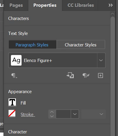

Jan 27, 2025 1:33 PM UTC
Thank you for your response Mr. Willi, attached some screenshots, hope they help.
