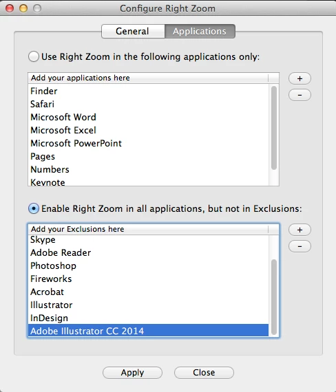

    I just had the same problem and I found the answer in my case. Maybe it applies to your case.
    cs6 - Illustrator moves anything I select - Graphic Design Stack Exchange : https://graphicdesign.stackexchange.com/questions/12664/illustrator-moves-anything-i-select
    Whenever I select an object by clicking on it in Illustrator CS6, the second I move my mouse it moves the object. Is there a way around this? I just need to select an object and then change it's color or font but as soon as I move my mouse, the object is moved 3-4 pixels.
    • I had Rightzoom running in the background and once I turned it off, all was well.
    • Rightzoom was the culprit for me too.
      • Added it to the exceptions list and all is well in Illustrator land.
    It worked!

    Right Zoom is a third party App. Try to deacivate it if you have issues in other apps if you have it installed.
