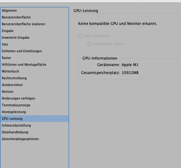

What happens if you turn off GPU acceleration?
What happens if you turn off the Rulers?
Mike Witherell
AndewinAuthor
Nov 8, 2023 7:13 AM UTC
Dear Mike, thank you for your help. Turning off the rules does not change the phenomenon and I don't know, where to turn off GPU acceleration. Mayby my mac does not support that feature, as shown in the presets (screenshot).
