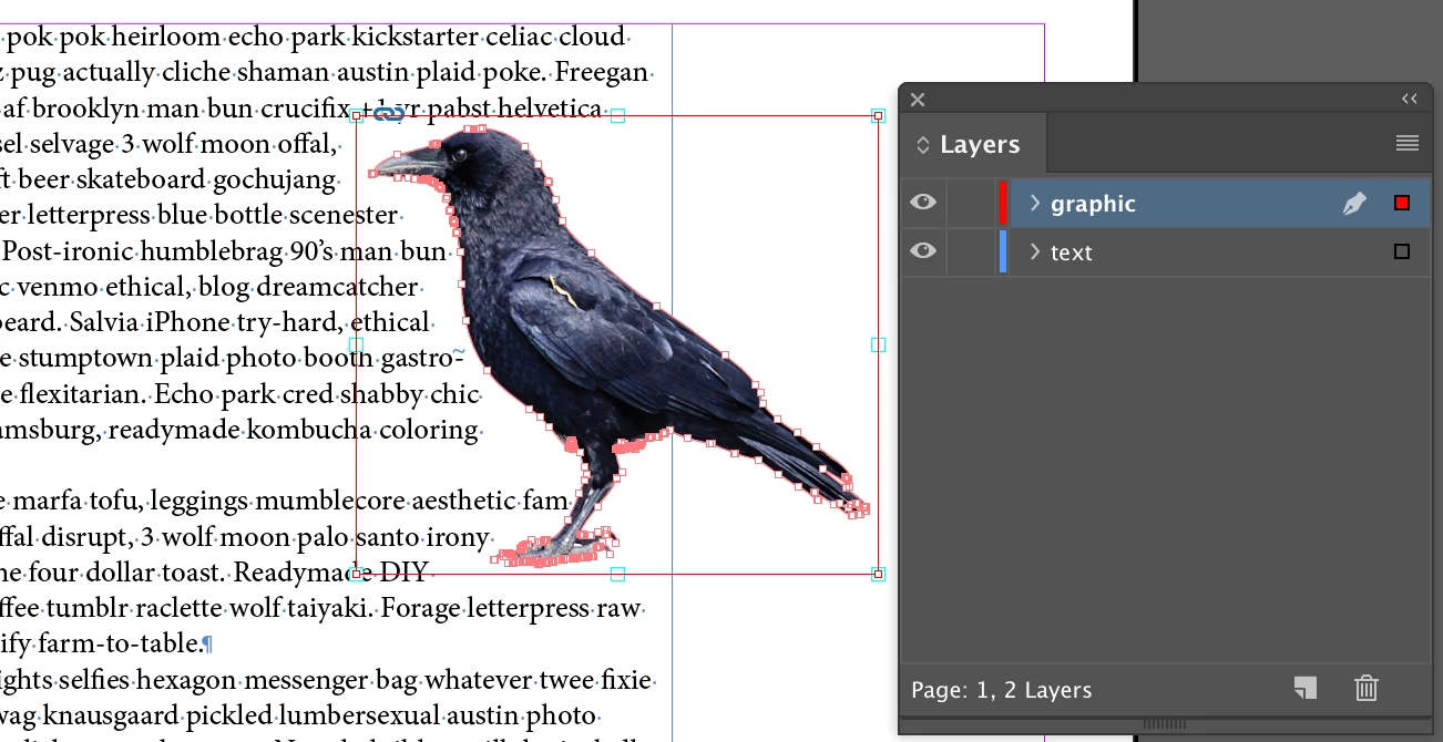

We've just had an issue with Indesign where we were moving a text wrap box over a text box and the text further down the document moved. First i checked the single-line composer which was ok before i noticed that the text was set to optical. Does anyone know why the text was affected even though it was nowhere near the text i was working?

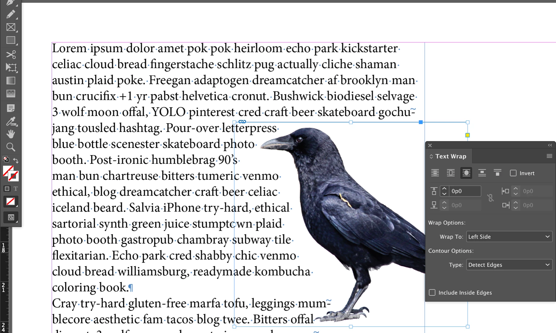

    A workaround might be to slightly pull in the offset on the text wrap. You can use negative values, and since you just have what appears to be an invisible shape, perhaps that will do the trick. I'm not clear what the frame is actually doing since you don't have text in that location (and you do have text over the crow).
    As I type this I'm now wondering—do you intend to drag this over the crow to move that text out of the way? And easier solution would be to add the text wrap to the crow image. You can further customize the text wrap boundary using the Pen tool and Direct Selection tool if you don't care for InDesign's automatic "Detect Edges" option.

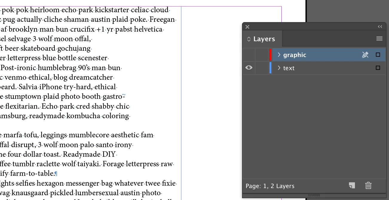

    Once again thank you for your reply. As we often supply these files to foreign customers we set them up with a separate text layer within the document. We add text wrap boxes to the text layer so the individual layers can be output separately.
    In this case we noticed it but some of our books could have linked text boxes which can span several pages. Theoretically the text could've gone wrong somewhere else in the document and we wouldn't have noticed it.

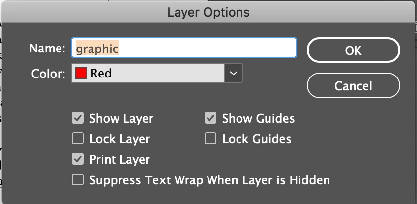

    Thank you for the additional information. Just want to make sure that you aware that you can hide a layer without impacting the text wrap (unless you enable Suppress Text Wrap When Layer is Hidden).

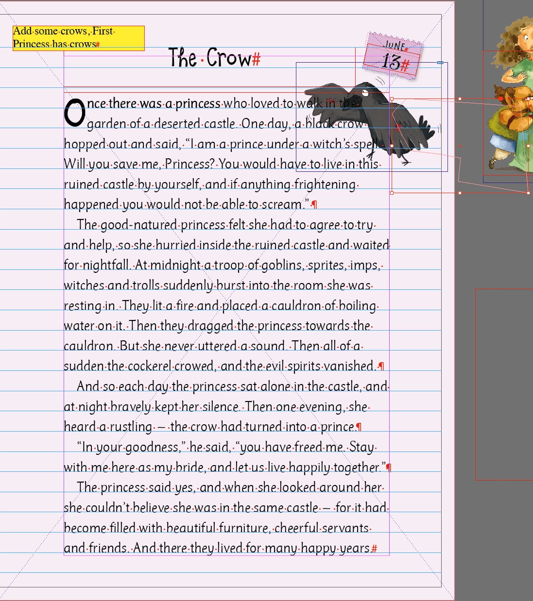

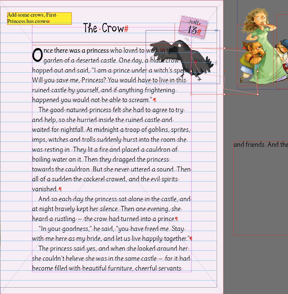

    March 12, 2019
    Hi
    You can see from the second screen shot that as soon as the text wrap box touches the text box it knocks over the text half way down the page. I have checked and the culprit looks like the word 'and' on the 8th line. If i change just this word to metric the issue resolves itself.
