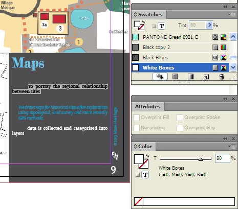

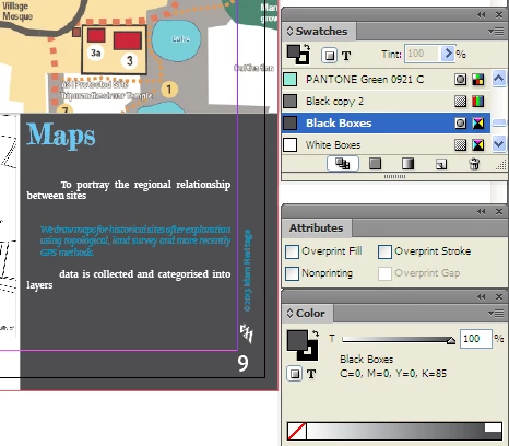

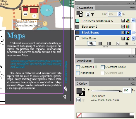

My white text would not print. I felt I had made no mistake, or did I? or did InDesign not let me correct (overprint fill option is greyed out for white!)?
The specifics are illustrated in the attached images:
1. The color value of "white boxes" swatch which is used for text
2. As is view of content without Overprint Preview
3. As is view of content WITH Overprint Preview (some white text disappears) - compare the area below the MAPS title.
4. Inspection of visible white text
5. Inspection of invisible white text (the cuplrit is nailed!)
But wait! the overprint fill option is disabled (greyed out) but shows a tick! I understand/assume that for white/paper this option is disabled. but then how come it is showing ticked.
Solution (hack?)
- Change the invisible text to any other non-white color
- Untick "overprint fill"
- change color back to white/paper
- Now white text becomes visible and is able to print!
Hmm, now is that not a software bug?

When you make a new CMYK swatch with 0 values (0|0|0|0) it is set to knockout and the Overprint attribute is not available, which makes sense because in process printing if a white object doesn't knock out it doesn't print—it's hard to think of a case where you would want process white to overprint.
You can start with a non-white mix, set it to Overprint then change the mix to 0|0|0|0 and it will remain as overprint with the Overprint attribute grayed out. So yes, if you start with a non-white CMYK mix and edit its values to white you could force it to overprint (not print). You can use your solution to change the overprint setting, or make the swatch non-white, uncheck Overprint, and set the color back to white.

If white cannot be allowed to overprint-fill (the property is greyed out) why changing that tick using my solution/hack helps?"
When you made the swatch it probably had some value other than 0|0|0|0 and you set it to Overprint, then changed it to 0|0|0|0.
