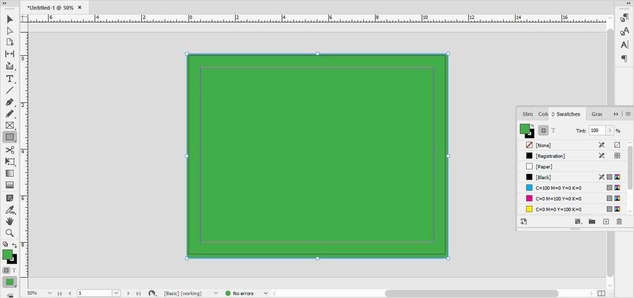

Are you making your color background by laying down a frame over your parent/document page(s) and filling it with the color you want to apply? You're not going to be able to apply color over a page without physically applying an element with that color above the page, as shown below.
Using the Rectangle tool highlighted in the Toolbar at left, I dragged a rectangle over the entire page and then selected a fill of RGB Green from the Swatches panel shown at right to fill it with color. Is this how you're applying color to the page?
If you could provide screen captures of what you're doing to apply your colors to pages, it'd help us help you.
