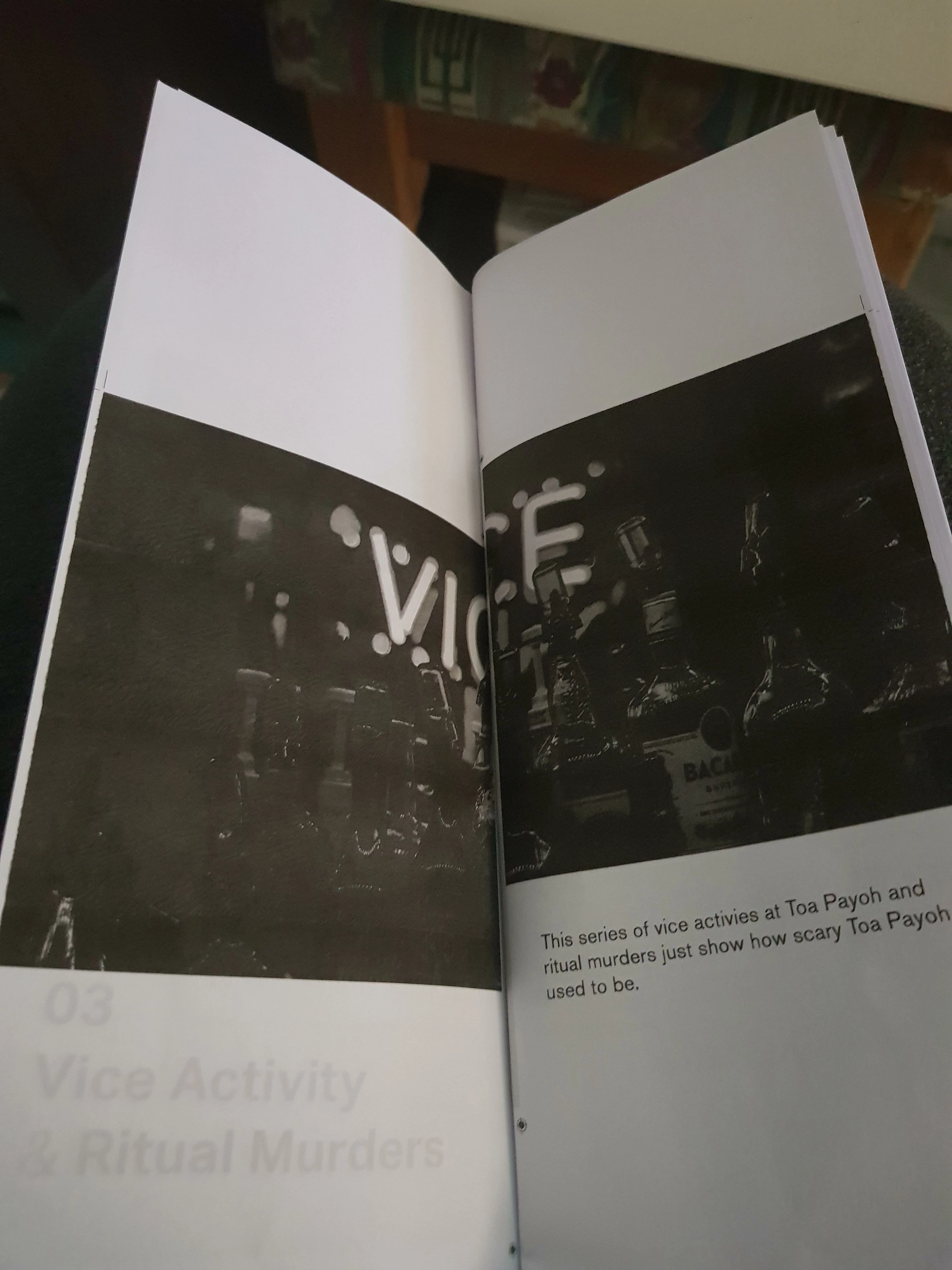

Hi everyone.So i recently started making this brochure for a school assignment so i arranged my pages to be sent for offset printing but when i layout my printed spreads ontop of one another the elements of the right side of the spread is below the left one although both spreads are on the same level when viewed on the computer screen and it creates disharmony amongst the spread. Does anyone know a fix to this?

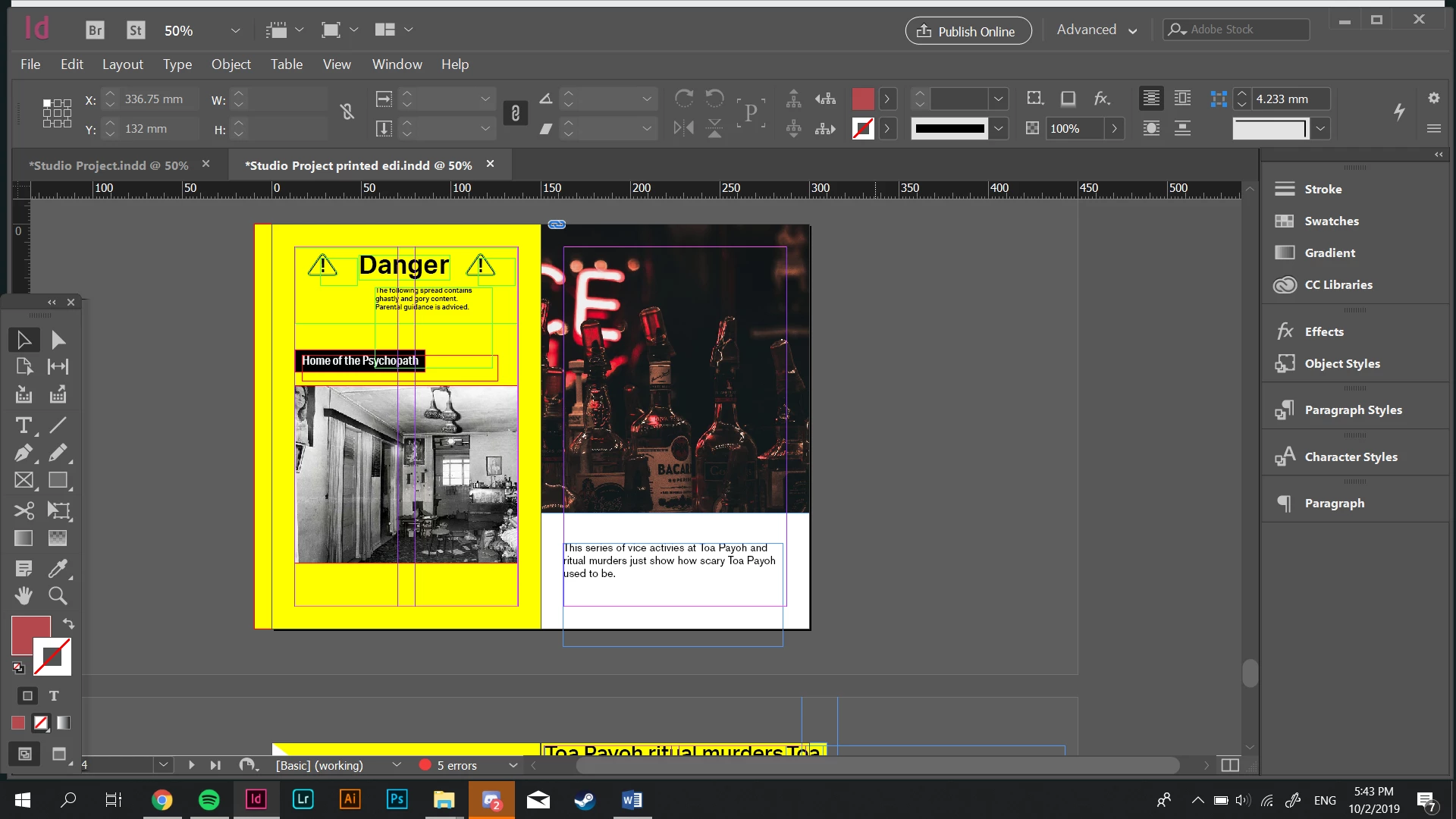

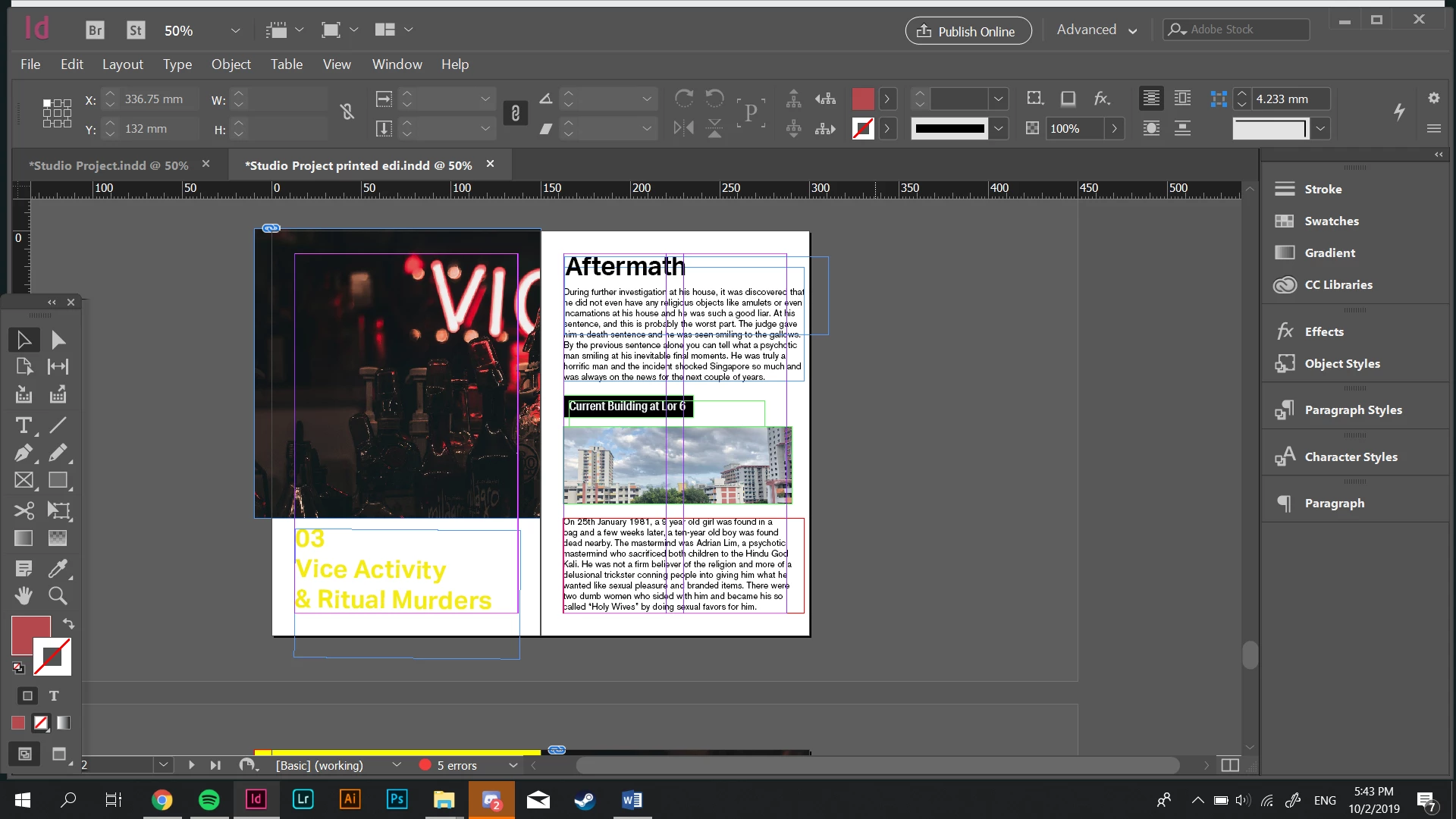

    a screenshot of your issue would help us to help you better understand your issue. We need to know how many pages, what size, what kind of spread and what kind of layout. A screenshot will help us see most of that and give you options.
