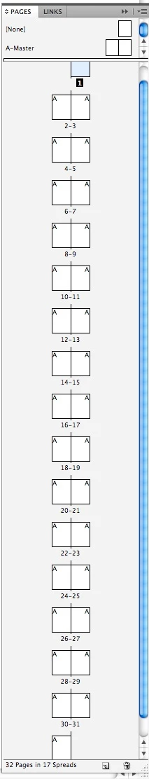

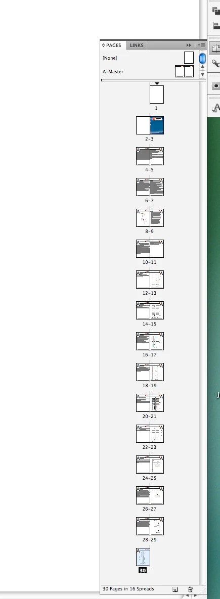

    Here's a photo of what I'm referring to.

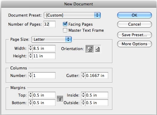

    I just tried to set up a new doc with 32 pages and it does the same thing.
    I selected facing pages dialog. (see the photos if they don't get cueued, what's that mean?)
    Yes, this is for offset printing, saddle stitch. There's got to be a way to set up in spreads, all the way through.

    Your pictures are stuck in the queue, so I can't look at them, but I'd suggest talking to your printer before trying to squeeze it into one document.
    Usually the cover is supplied as a seperate file, and the printer imposes the remaining pages.
    I'm all for imposing, so a workaround is to make your first page start on the verso. You can do this by setting up the page numbering and section options and having it start on page "2". If you're doing auto page numbering, your next section starts page numbering with "1" (or whatever).
    You'll still probably need to export two PDFs (one for the cover as a spread, and the rest of the pages individually).
    If your inside cover has printing on it, you may have to impose those yourself, too, as a spread.

    Depending on how the book will be printed and bound, you may not have the right number of pages here. Stitched books need to be in multiples of 4 pages. Perfect-bound or loose bindings like spiral or GBC can have any number of pages, but if you want a spread for the cover it sounds like you plan to fold and stitch. If that's the case, you need to add blank pages to bring the count to 32, or reduce the count to 28.

    InDesign builds documents in the same view your readers will see. When the booklet is closed, they see only the front cover or only the back cover. If this is a "self-cover" booklet you can either put the back cover on the last page, or if you really need to see the entire cover as a spread you can force ID to start on a two-page spread in a number of different ways. I fthe back cover will be pg 32, for example, set the strat page number to 32, and then start a new section on the page for the front cover and restat page numbering at 1.
    You design your document in readers' spreads, but it gets printed in printers' spreads. It isn't just front and pack cover that get put together. It's printed as first and last, second and next to last, third and third from last, and so forth get ganged. This is called imposition, and it is the printer's job to do it, not yours. Trying to lay out a book in impposed spreads is difficult, at best, and a waste of your time.
