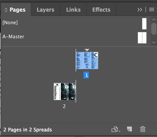

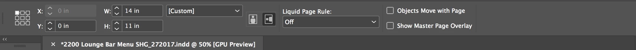

BarbBinder - here's the pages tool screenshot.
and the pages layout

You can see from your screenshot that the master pages match the document setup dimensions. Your screenshot confirms what Bob and Bill figured out: that the designer used the page tool to resize body pages 1 and 2.

I agree with Bob and Bill. I keystroked it and couldn't make it happen—until I tried the Page tool.
Now, do you need to reset it or did you just want to know what was going on? If you do need/want to reset it, select the Page tool, and restore the dimensions to 4.25 x 11 via the Control Panel. Then return to Document Setup and type in the desired page size.

It looks to me like the page size for the document pages has been changed using the Page Tool (that's the one right below the selection tool [black arrow]). Click on the page using the page tool and you should see its actual size in the Control Panel. As you say the correct way to set the page size is through the Document Set-Up but I have seen it done using the Page Tool before—usually by inexperienced users.

I just checked out the screenshot. I’m changing my guess to someone using the page tool to change the size.

Sounds like it’s a 3 page spread. FWIW, I’d do it as a single page with guides as well.
