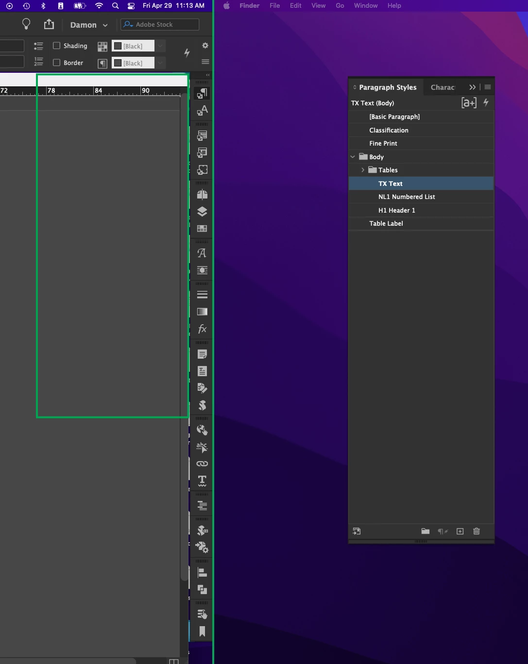

I have two monitors, and I run InDesign on the left monitor. Before updating to InDesign 2022, tool panels (Paragraph, Pages, etc.) used to pop to the left of my right-side-docked toolbar (see image; I outlined in green where the panels used to pop).
Now, they pop to the second monitor, and considerably distant from the toolbar for some reason. If I try to move the panel to the left, it removes the panel from the toolbar (what??). If I enable the application frame, it behaves as desired — except that the application frame is annoying, and I don't like it.
This happens with all of my workspaces, even the default InDesign workspaces. It used to keep all of the InDesign application UI elements on my main monitor. Now if I have a full-screen app on my right monitor, the panels can't be accessed unless I switch away from the full-screen app.
The image shows a green line that separates my two monitors as well as where the panels used to pop (green rectangle).

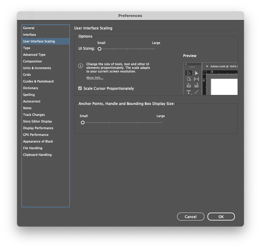

Correct answer lesliew38841375
Thank you SO much. Changing UI to small fixed it!

I know I'm late to the party, but I found a fix for me. I changed the UI sizing down to small on the top slider and it no longer pops onto second monitor.
lesliew38841375Correct answer
January 15, 2024
