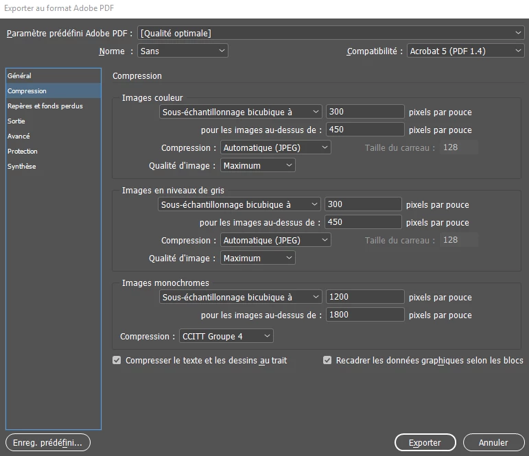

    1. Was your original TIFF file saved without compression? There are people who dislike using any compression at all (no doubt because of a Bad Experience with low resolution JPEGs), and so they even distrust "LZW", the completely 100% Guaranteed Lossless Compression™ (which is the same as the *very* common ZIP compression, and that is generally trusted to not lose the odd bit or byte under any circumstances -- if it did, you could not safely compress-then-decompress any file at all).
    2. Did you use the standard "High Quality Print" or "Press Quality" export presets? These two presets are set to use "Automatic" image compression, which defaults to lossless ZIP for 'simple' images -- say, screenshots or line graphs -- but to JPEG on photographic images. That means that yes, some detail may be lost -- but it's for print, and the default downsample resolution is twice as high as necessary. Those details lost in JPEG translation would still not be visible, because at print time each halftone dot is about double the size of each individual pixel.

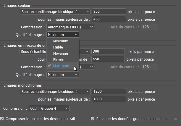

    I think you're right: exporting a pdf in Indesign without compression gives a file with the same size than the original.
    And I've seen that the jpeg compression was not set to "maximum" but "Medium"
    Now the pdf file size is about 2 Mo. And I've discovered that the compression was so effective because there is a lot of white in the image. (Algorithm is powerful)

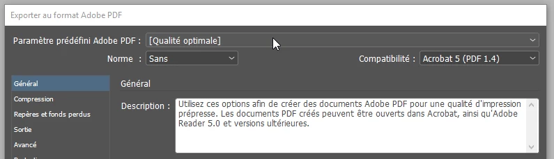

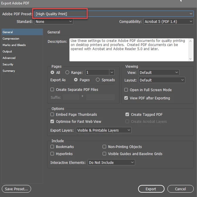

    It looks like you do PDF with small or standard settings. Did you try it High-Quality print preset?
    Remember, never say you can't do something in InDesign, it's always just a question of finding the right workaround to get the job done. © David Blatner
    patpix17Author
    October 21, 2019
    Thx for reply,
    Yes with default parameters.

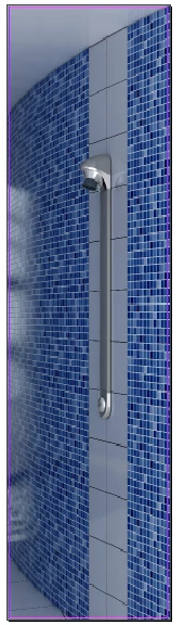

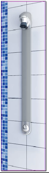

    Here is the PDF export
    The imported file
    The image resized to 800x3000mm in Photoshop
