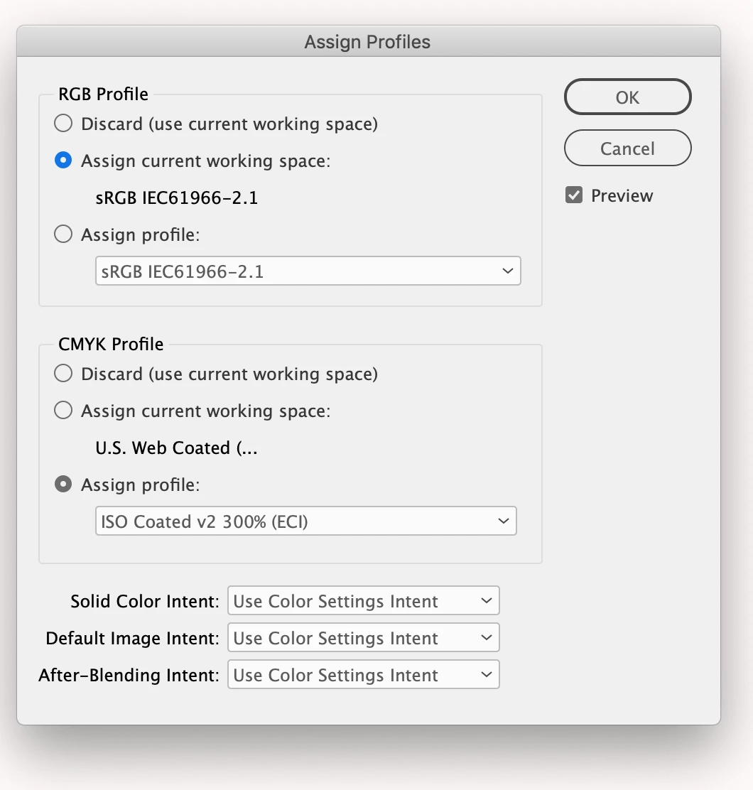

Hi @franziskaf24503411 , Before you export, check to make sure the document’s Assigned CMYK profile is also ISO Coated V2 300% (see Edit>Assign Profiles...):

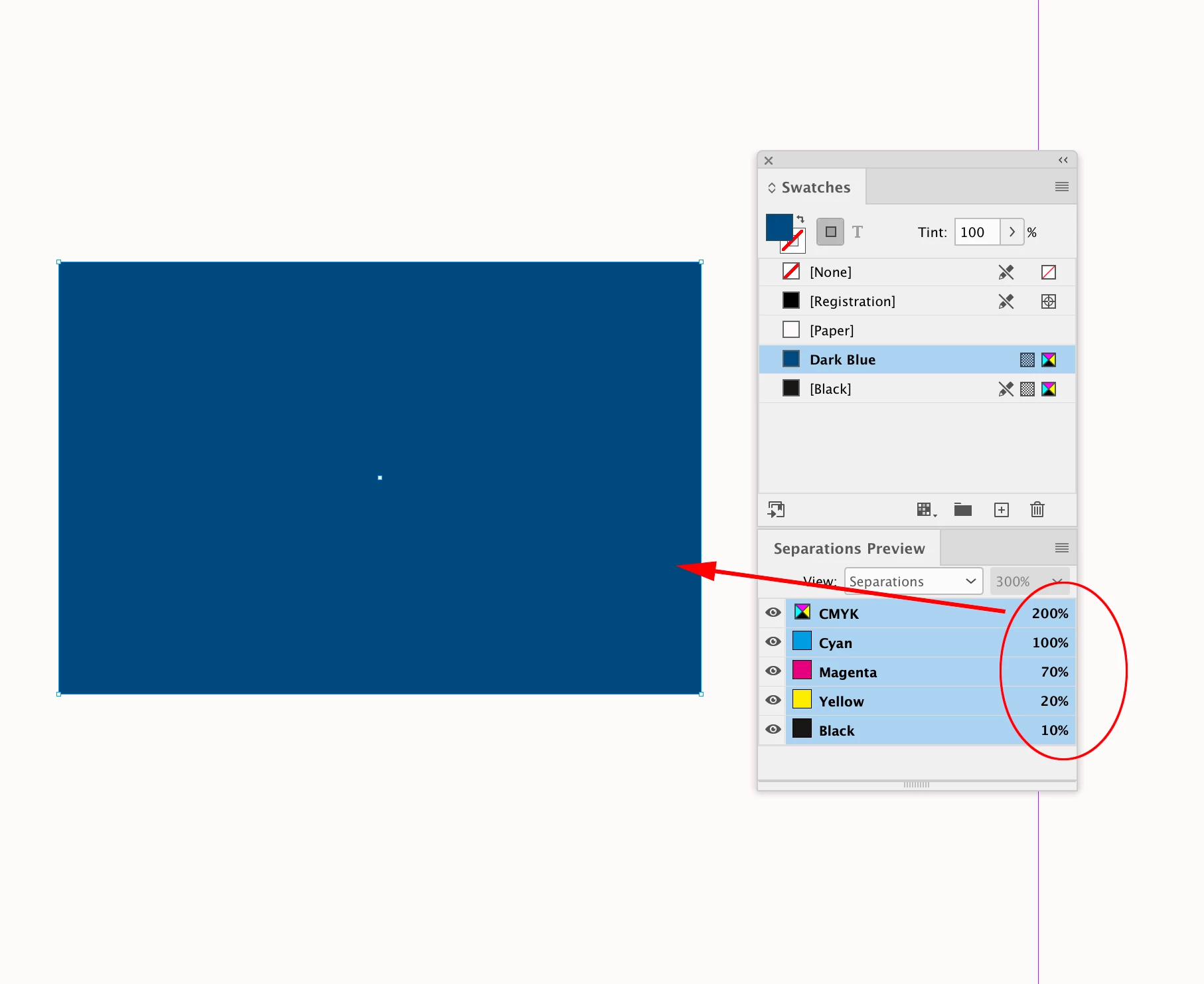

And also check the actual document color values with Separation Preview panel—it sounds like there was a color converion on the Export to PDF.
