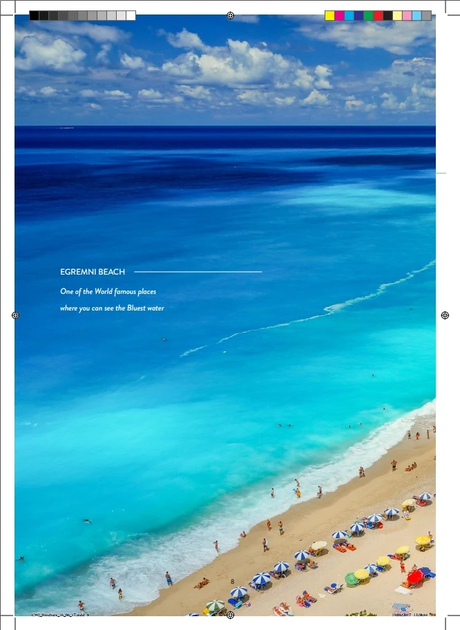

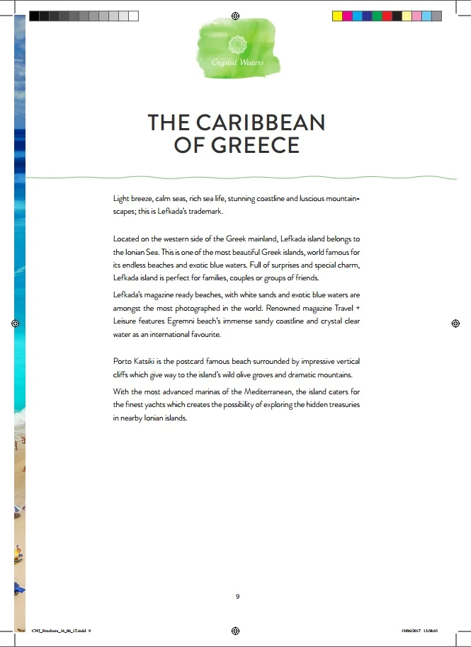

The problem is that, now that I need to export it as export as single page, the whole texts and images are not centred. They are all centred and correct in InDesign file.
When I export it as two page, it exports ok.
When I export by page (not spread), it gives me the same problem.
I really don't know what the problem is here, can you guys help me please?
Please see the attached picture for better understanding. Thank you!!

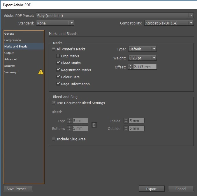

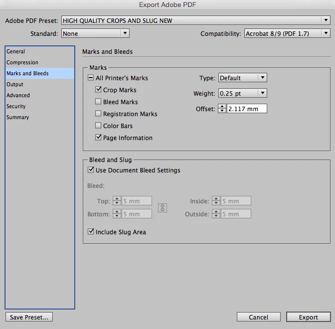

I just realized that I did not notice before that you have the bleed marks checked rather than the crop marks. Ignore most of what I said above. If you check the crop marks instead of the bleed marks you should be good. If these pages are to be separate pages then the beach image will need bleed on both sides. If this is to be a spread then it should actually be output to pdf as a spread.
I just took a look at your files and with my settings set up like the screen shot below I had no problem with the centering:
As I said, use crop marks rather than bleed marks. Looking at your file I still am unclear as to why you want to output it in single pages.

I unticked a bleeding marks, and it solved the problem. Thank you @Bill Silbert and rob day for the right answer.

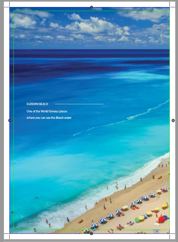

Based on the fact that the slug lines for the .indd document are right on the trim line it appears that something was altered in the actual InDesign document. If the InDesign document was set up correctly to the trim size and you output the pdf with document bleed checked (as you have) then the slug line would actually appear below the bleed area. Without seeing the actual InDesign file it is difficult to say what needs to be fixed as the settings in your export to pdf dialogs look good.

If I export it as a spread, it exports two pages attached next to each other, as shown in the image. I want it to be a single page..

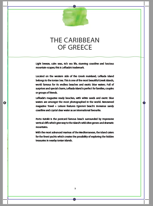

You've included an inside bleed. With facing pages, the inside bleed comes from the opposite page. This is normal behavior—for most binding methods the inside bleed will get removed when the pages are imposed.
So without an inside bleed (showing bleed and registration marks). Note that the green bounding box is the trim, so the text block on the 2nd page is centered:
