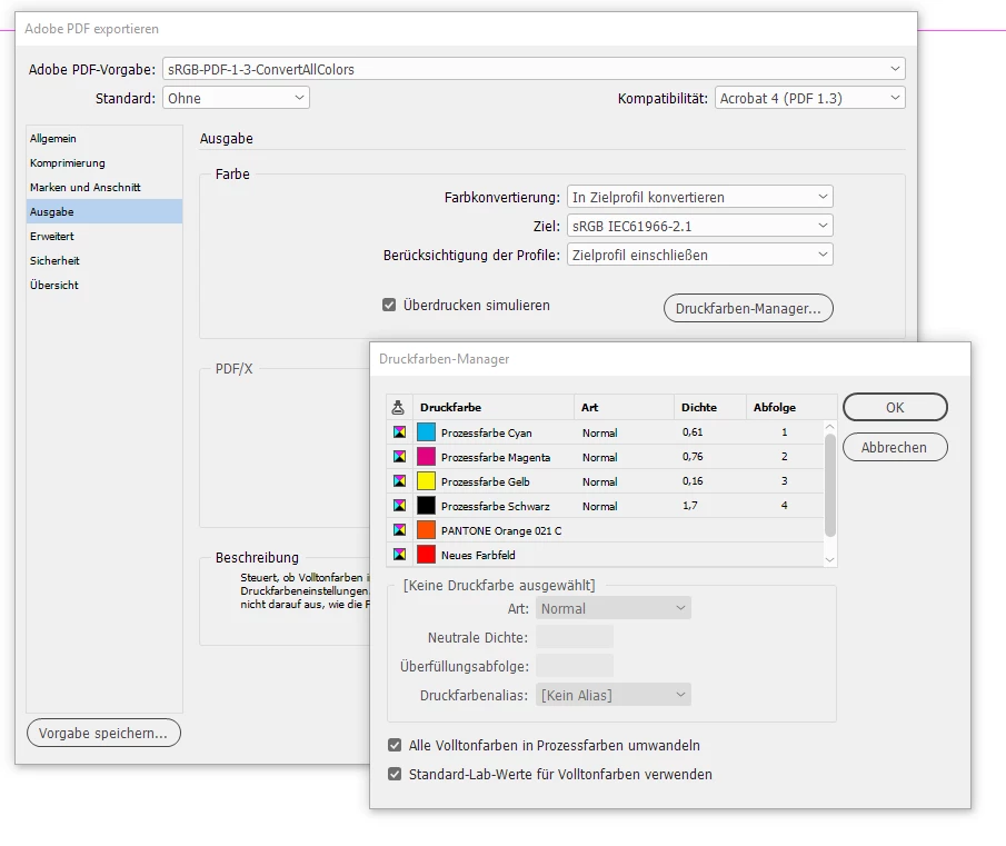

Then I would suggest the following that is by no means meant for a commercial printing situation like offset presses, just for office printers and all PDF Viewers including viewers in browsers. From my German InDesign:
Set compatibilty to Acrobat 4 (PDF 1.3).
Standard: None
Output > Color >
Convert to Destination
sRGB IEC61966-2.1
Include Destination Profile
Simulate Overprint
Test two cases with your document and see what fits best visually:
Edit > Transparency Blend Space >
Document CMYK
or
Document RGB
If you are working with spot colors also test two cases:
Ink Manager ( that's "Druckfarben-Manager" in my screenshot above )
[ ] Convert All Spots to Process Colors
Uwe
