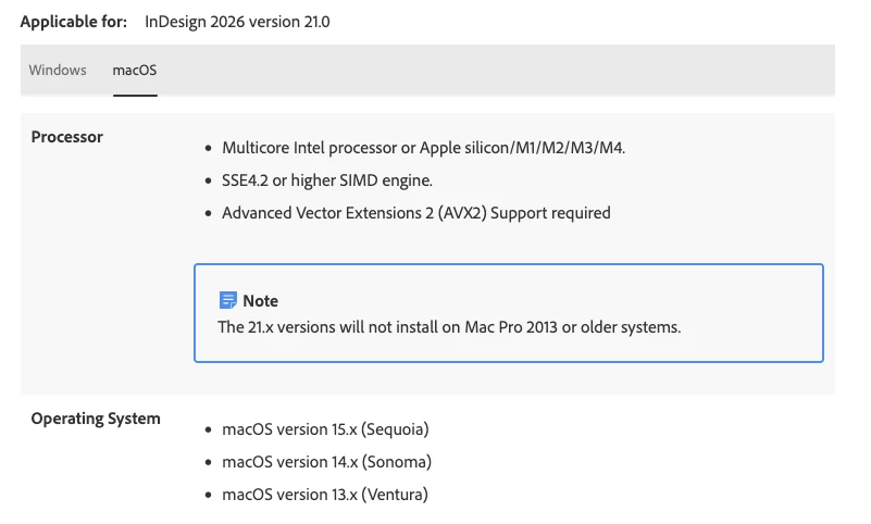

Nov 6, 2025 8:16 AM UTC
1: Yes, i have startupshutdown service implemented in my plugin. The thing is that it does not even call the Startup() method, the crash happens earlier. I added logging to the very beginning of the Startup() method and the logfile does not get written.
2: I use Xcode Version 26.1 (17B55) on MacOS Tahoe (26.0.1). Could that be a problem? I've seen that the system requirements do not mention Tahoe
I compiled the WriteFishPrice example plugin and it runs fine, though.
3. Ok, i will have a closer look but the crash happens before the Startup() method is called and i literaly do nothing before it.
Thanks
