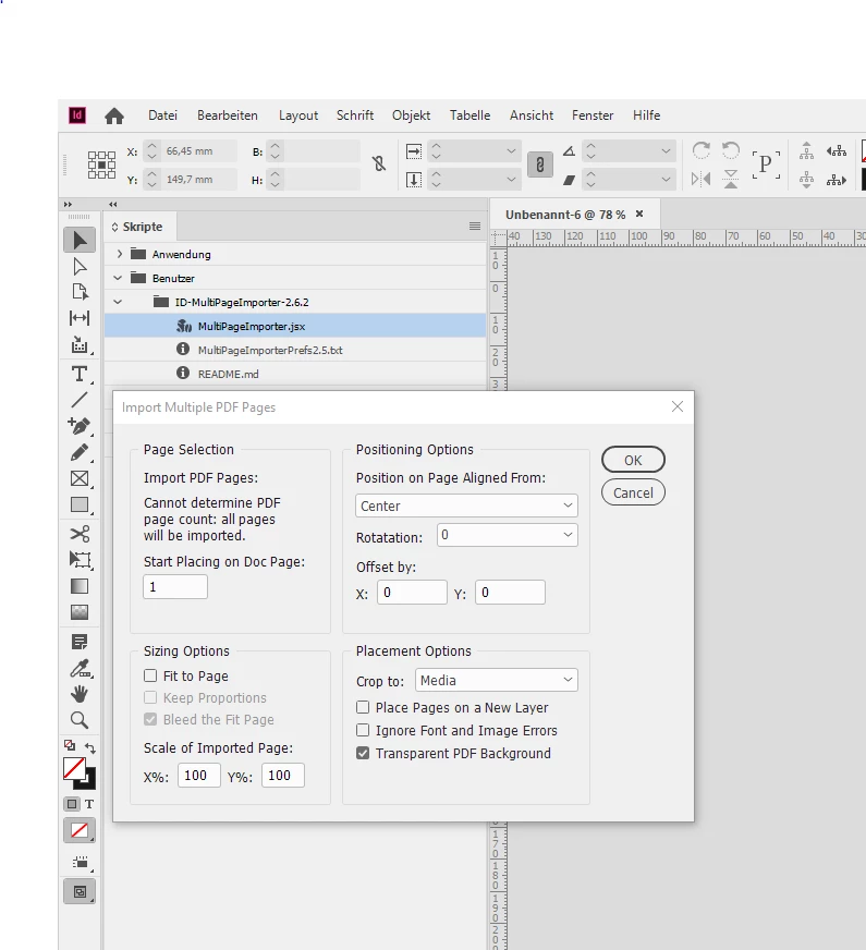

Hi Mouse Waver,
if you are only printing to PostScript, because you want to do a size change, consider a better workflow:
Export your A3 pages to PDF with the PDF/X-4 preset where you do not do color conversion or downsampling of images.
Place the exported PDFs scaled in a new A4 document and from that export to PDF for your client.
Use the MultiPageImporter script originally written by Scott Zanelli, now curated by Mike Edel,to automate placing and scaling your A3 PDF at the same time:
https://github.com/mike-edel/ID-MultiPageImporter/releases

Thanks for that, Uwe.
I did bookmark the Zanelli script in 2018 and 2019 along with a similar one from "Dr Scripto".
Am sure I have used it but can't remember why I removed it. Maybe it was a trial version or I had some issue with it at that time.
Tried your suggestion and it worked fine, I got a larger pdf than I was getting before but will play around with that.
