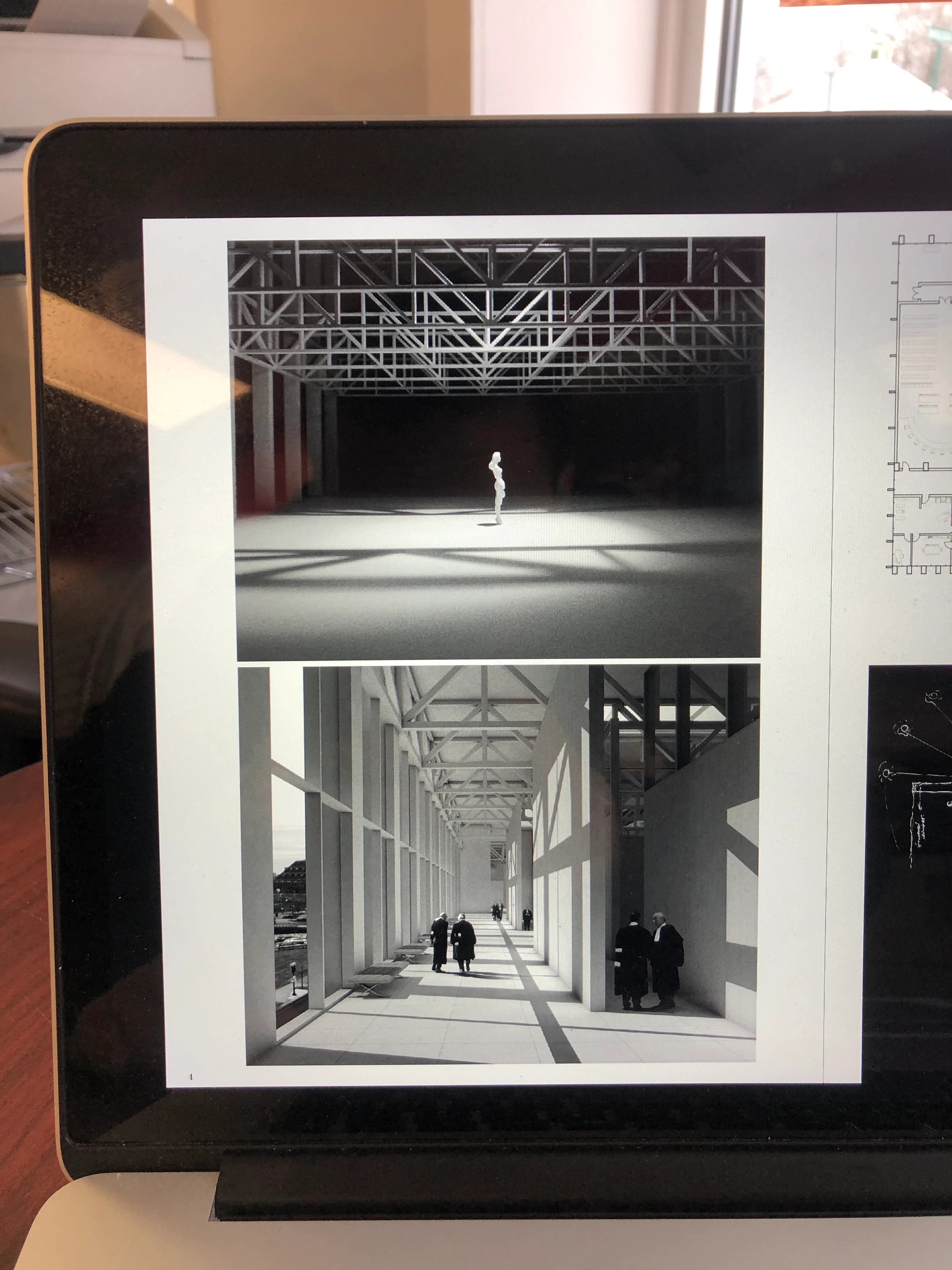

Hello, everyone. I have run into a frustrating situation recently. I am trying to print my art portfolio, which includes a variety of mixed-color and black-and-white pages in a booklet. However, I can't seem to get the black print to match what appeared on my Mac screen.

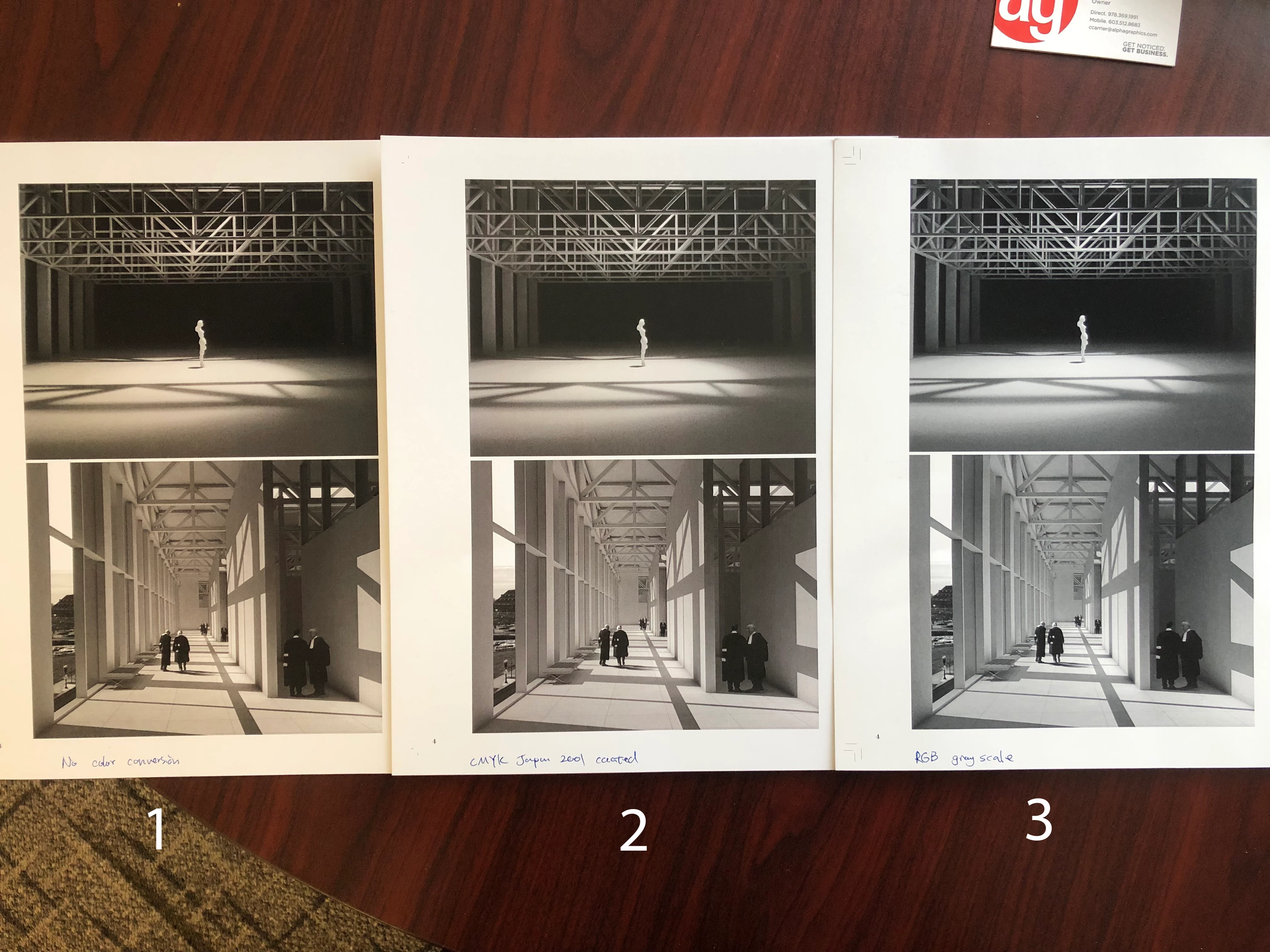

The computer screen black (see attached photo) is ultimately the final goal I am trying to achieve. However, there are 3 different colors (see attached photo) from the printer:
  1. very yellowish, no color conversion when I exported from InDesign. I assume the printer converted the RGB color to this yellow one.
  2. less yellow. "Convert to destination preserve numbers" in InDesign, color profile Japan 2001 coated. I am not sure the print shop printer's CMYK color profile default setting, but Google says most North American printers use this Japan 2001 coated profile.
  3. was printed as grayscale from a no color conversion file. This black and white is actually what I am looking for. However, I am trying to print an entire booklet double-sided, so there's a very high chance that there is a color image somewhere else on the other side of the paper.

Correct answer Peter Spier
So just one or two copies, I take it. That's definitely a digital print job (color copier) which means composit color output so your grayscales may get a cast.Youcan get a sample printof one of your grayscales without buying the whole book before you finalize your file, and I would definitely do that, and one of your color images as well. You could put them together on a single page for testing.
Pages with color typically cost a lot more than black-only in that kind of output, so if you can keep any pages all black that will save you a bit, but with such a small project it won't amount to more than a few dollars difference most likely. Each side of the sheet is considered a page in this scenario.

Is your monitor calibrated and profiled? No way to know if the output matches the monitor if not.
How big is your run? I've worked with some printers nominally in the Boston area (and I can ask some colleagues), and Rob is perhaps in a position to make a recommendation, as well.
Not sure where that’s coming from—InDesign’s North American PrePress Color Settings’ preset uses US Web Coated SWOP as the default. For sheetfed printing on coated papers something like Coated GRACoL or ISO Coated V2 is a more common profile—ask your printer before assigning Japan Coated
Hi @Felix Rossi , Are your examples from a composite desktop printer or a commercial offset printer? If you are proofing from a composite printer, that wouldn’t necessarily be an accurate prediction of press output. Composite printers almost always use RGB drivers and there would be additional color conversions performed by the driver on CMYK or Gray values, which could introduce color casts.
What is the color mode of your "Black and White" images? Do they show as Grayscale in the Link Info panel?

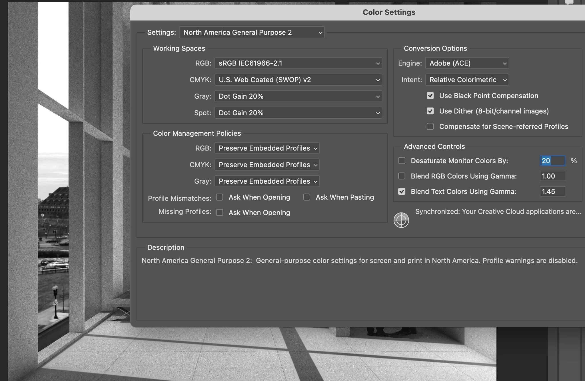

I checked Indesign, it color space shows up as RGB, the following screenshot is photoshop color setting. I guess, those photo maight appear to look black and white on my screen, but they are in RGB channel

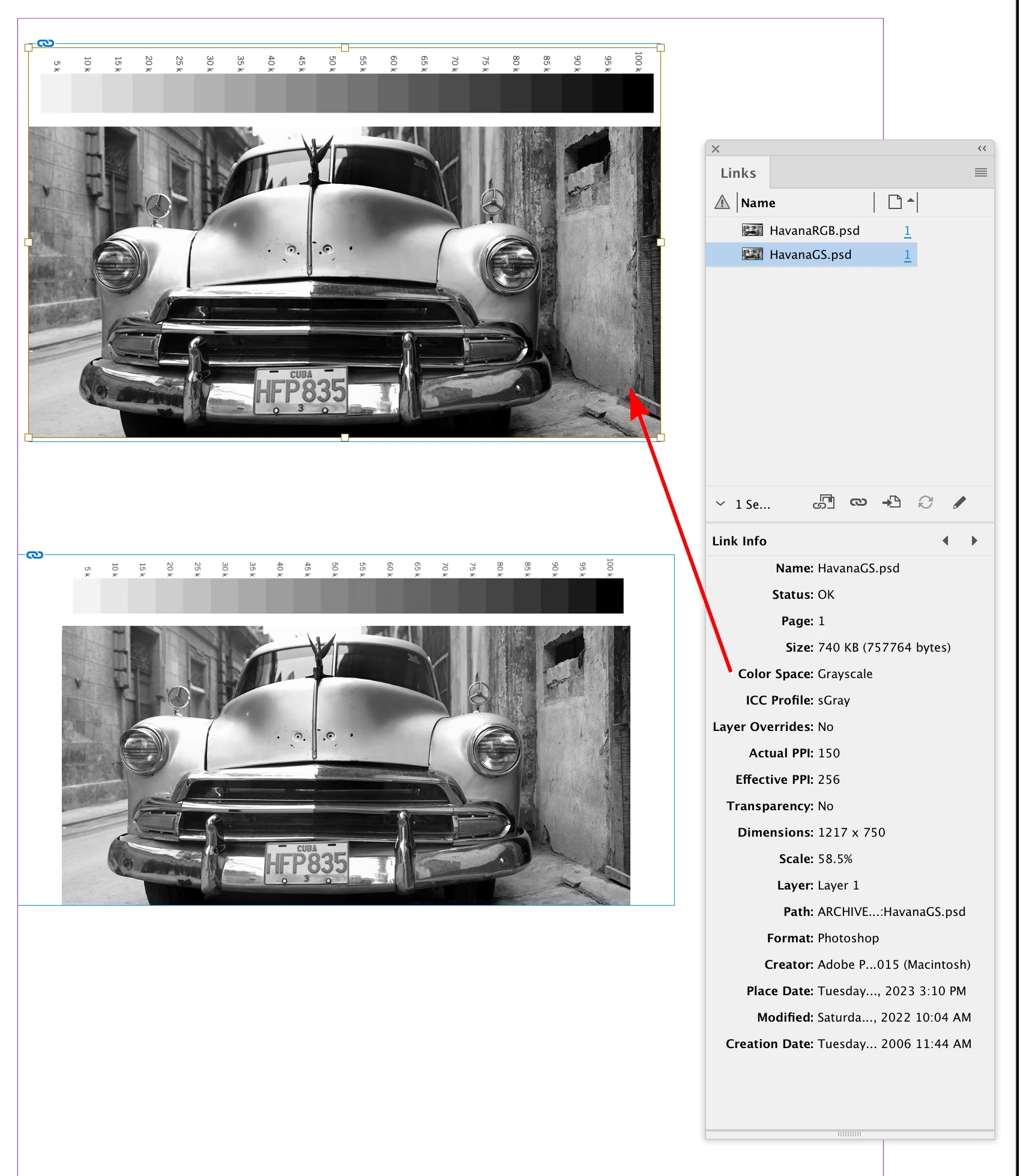

rob day
March 14, 2023
InDesign doesn’t have a document color mode, you can mix objects with different color spaces and profiles on the same page. Here I’ve placed and RGB and Grayscale version of the same file—the two images would export with different output values.
If you place Grayscales and Export a PDF with No Color Conversion, or to Document CMYK, the grayscales will export to the CMYK Black plate unchanged. On an offset press a grayscale on the black plate would have no color cast, from a composite printer a cast could be introduces by the driver depending on the setup
