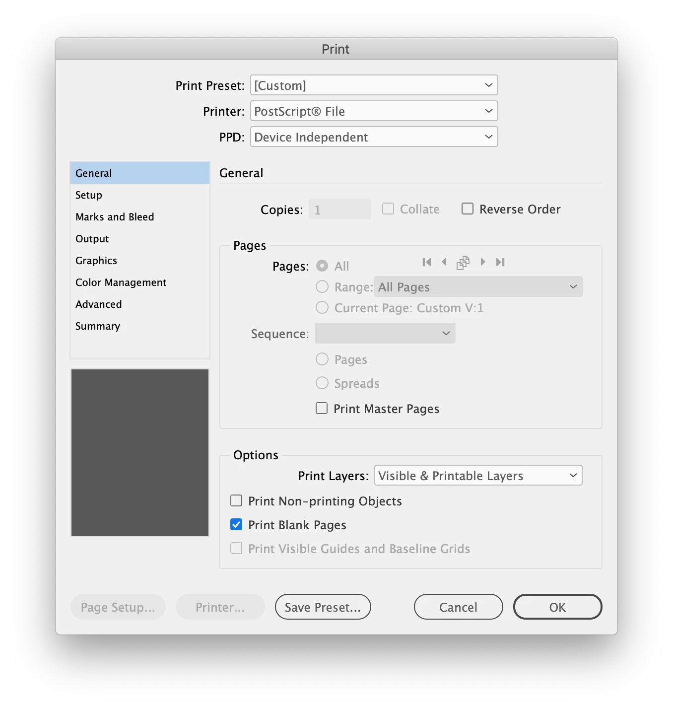

File - Print Booklet
Printer is set as a PostScript file. (If I go into print settings and select a printer, it prints instead of saving as a PostScript file, so I'm forced to leave the PPD settings at "Devise Independent.")

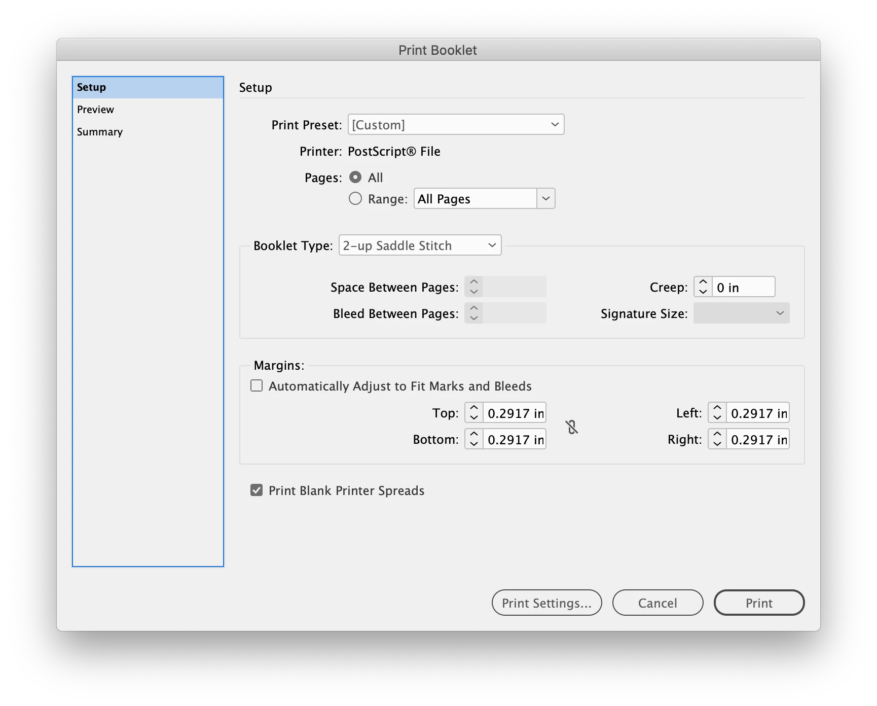

So my setup looks like this:

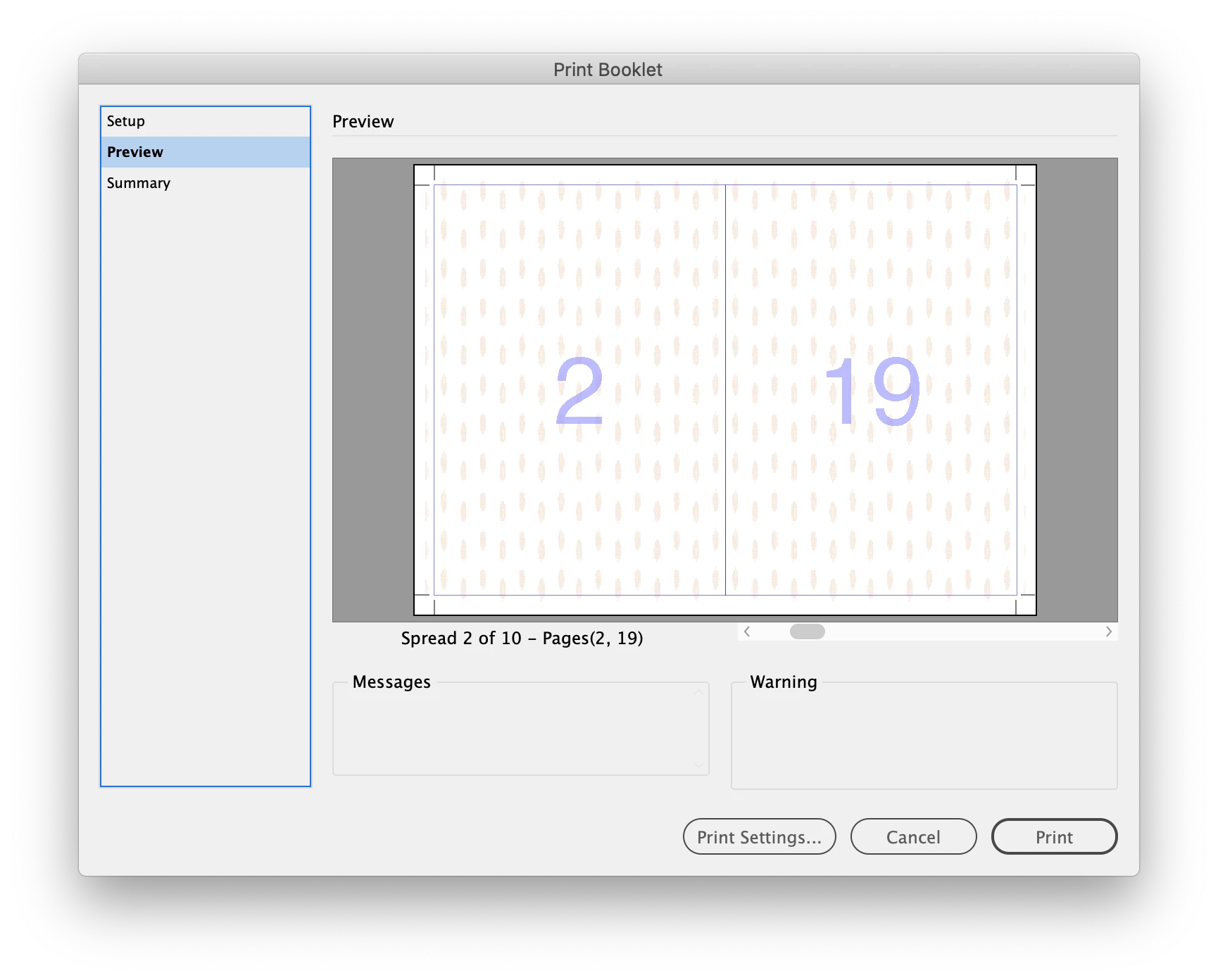

And my preview looks correct:

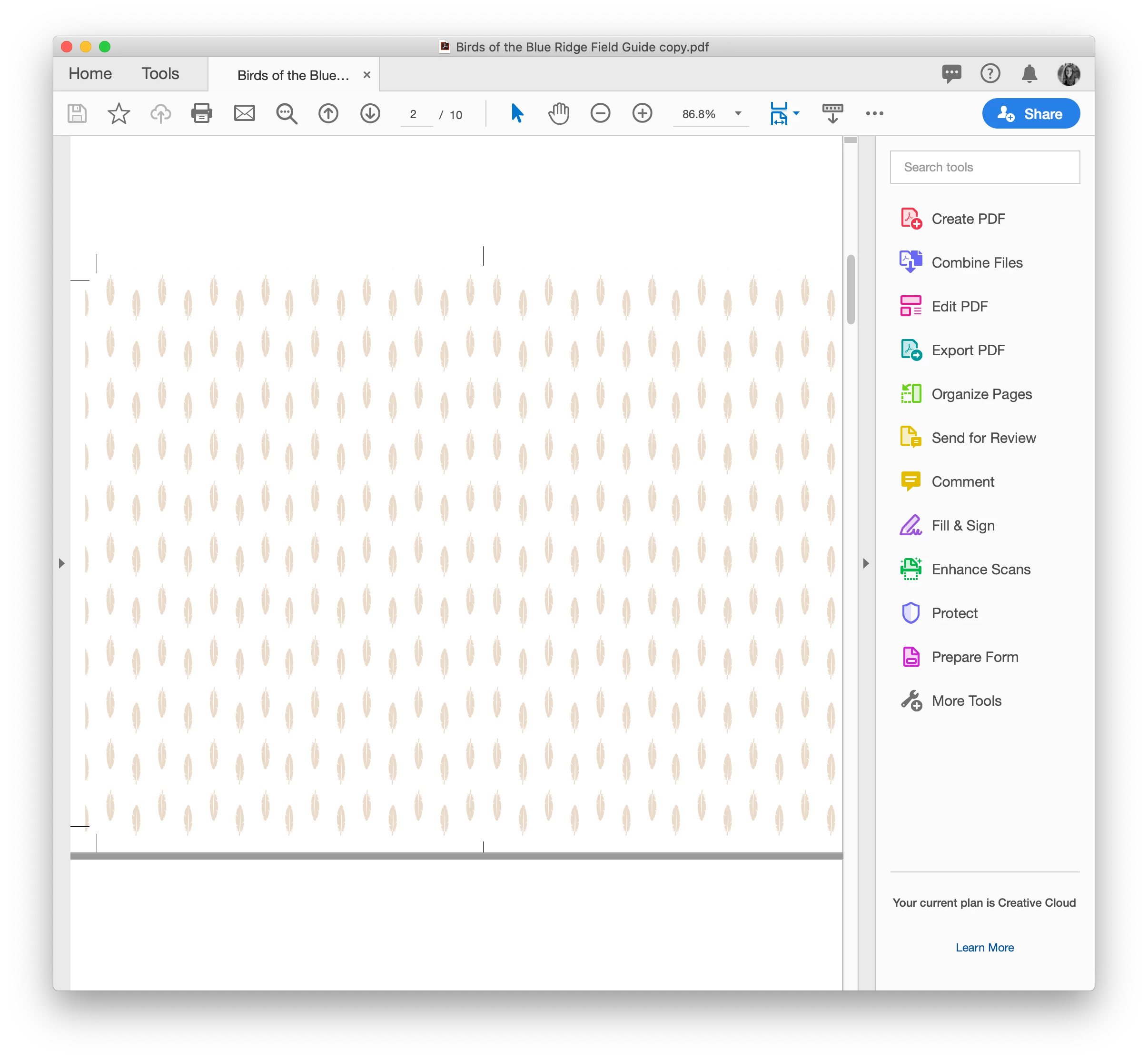

However, when I click "print," the resulting PostScript file cuts off content if the spreads are larger than 8.5" x 11". Converting the PostScript file to a PDF does not solve the problem.

I've seen the solution proposed about printing a booklet from Acrobat, and curious to know more about how this works. If I need bleed and crops (which I always do), it looks like Acrobat doesn't eliminate the bleed & crops in the spine area, and adds space in the center of the pages:
Choosing "booklet" for the binding type in printer settings doesn't solve it, either. What's the best way to do this?
