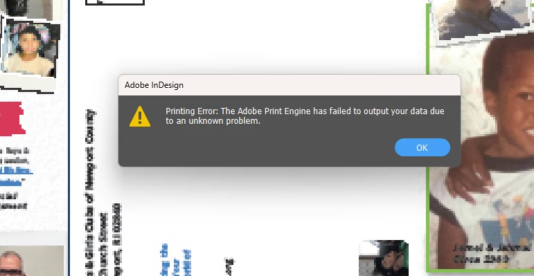

I'm running into a frustrating issue when trying to print directly from Adobe InDesign (v. 16.0-20.3) to our offset press via Presstek RIP. Every time I send a job to the press, the InDesign print dialog initiates the job, but then fails with a "Print Engine Error" message.
Here’s a breakdown of the setup and what I’ve tried so far:
Software: Adobe InDesign 16.0 (this has traditionally worked - anything newer gets the error every time)
RIP software: Presstek RIP
Press: Presstek DI press
Connection type: Network
What I’ve tried:
Restarted InDesign and the RIP software
Verified printer presets and PPDs
Has anyone experienced something similar—especially the Print Engine Error when going directly from InDesign to RIP for offset printing? I’m wondering if this is a compatibility issue, a bad PPD, or something deeper with how the RIP interprets InDesign’s print job.

Hi @tiffanykustwan11 , Does Print Engine failure happen with all documents—if you create a new document with just default fonts and no placed assets do you get the error when printing separations?
Oct 8, 2025 12:19 PM UTC
So to answer this question, it is currently only happening with 1 file. We have to send files using InDesign 2021 because I have tried anyting newer and all files will fail at that point. The attached file is the only one giving me an issue. I have run all different pre-flights and fixes as I have a feeling it has to do with the fact it's a client supplied file that was originally design in Canva. It seems we are having more and more issues with supplied canva files like it is getting harder to work cross platform with adobe/canva. I also tried converting to .eps file and it still won't print out of InDesign.
Any other ideas?
You might start by looking at the placed assets’ formats. I’m guessing if you opened all the images and resaved them as .PSDs, and resaved any vectors as .AI format in Illustrator, that might be a fix. Avoid EPS if you can.

Adobe's recommendations for this error:
https://helpx.adobe.com/indesign/kb/error-print-engine-failed-print.html
You can also try these general troubleshooting steps:
https://www.rockymountaintraining.com/adobe-indesign-rebuilding-preferences-cache/
Oct 8, 2025 12:15 PM UTC
I have tried all of this and it is still not working.
