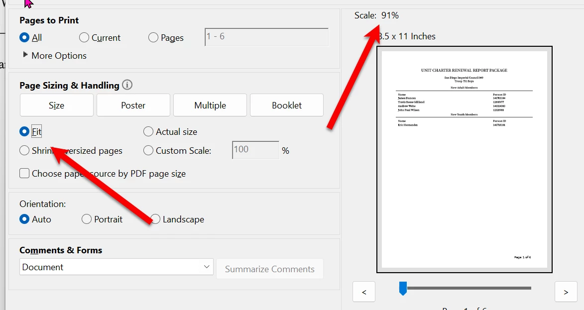

What do you Acrobat print settings show?

Check your scale and fit settings in the Pharos print driver.
Since you can't bypass this app, the only other thing you can try is to try printing the PDF to a non-campus printer.
