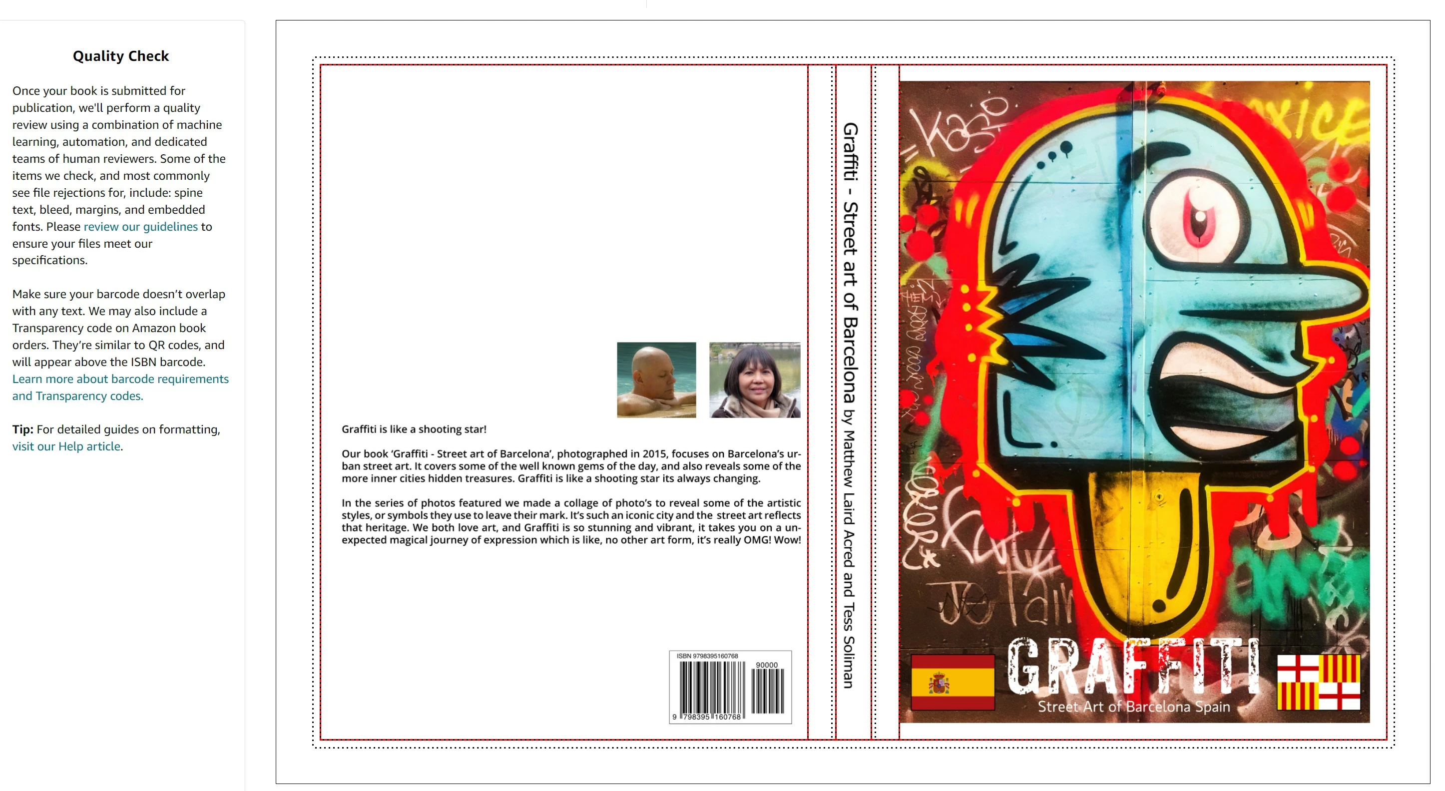

I've been trying to print my book to Kindle - KDP for several weeks one of the most frustrating things I've ever had to do. I thought this program would make life easy. There are so many variations when you try to print. Despite having the correct measurments InDesign doesn't stick to the measurements.
How do you print a cover for example when its 3 pages it only gives you the measurementes for one and not combines. Why hasn't Adobe made things easier for doing books on Kindle??

Hi Still having issues with getting the cover done!
I've attached a test document (please be careful as there a lot of 'loose' elements) for example the flags have a border on them but not constrained to the flags - not sure if it's intentional
Here's my take on your settings
You have hardcover selected -so you need EXTRA bleed for this.
This is because the paper itself is wrapped around the hardcover and glued to the inside of the board.
So your bleed should be the WRAP setting
Where it says 'hinge' - this is a safe type area - no text should be included here or anything of value - artwork/backtrounds' are fine.
This is where the board is scored to allow the book cover to open and close without damaging it (checkout any hardcover book)
Set your front page inside margin to be 0.394
Set the back cover outside margins to be 0.394
When I do this -  you see your Spanish flag is on the crease
You can see your artwork is outside the 'Margins'
For this it will need to be either inside the margins
Or go full bleed

This is how it looks
