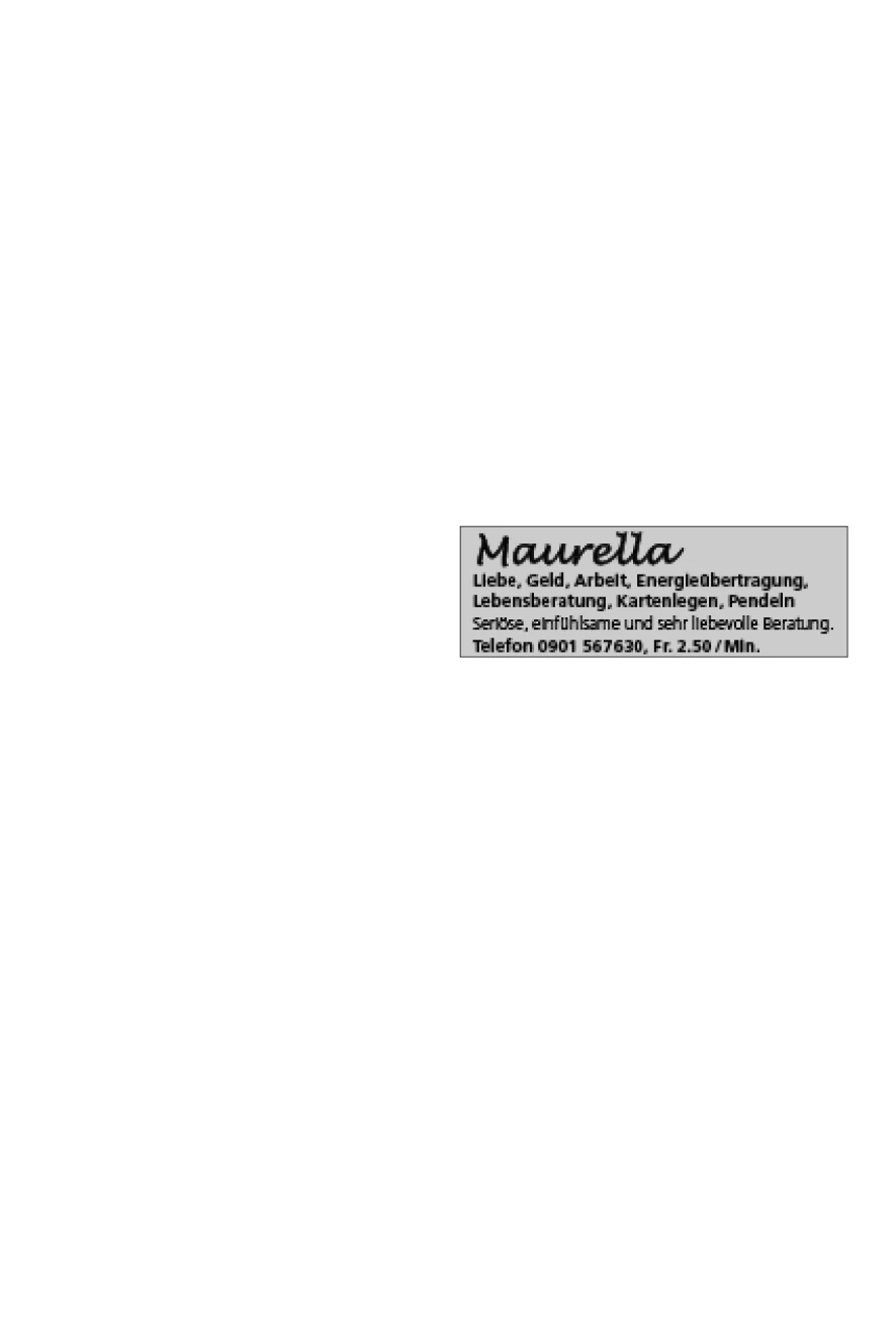

Sadly the size of the Layer is to big. The whole site gets exportet to a jpg, but not only the LAyer it self. The size should be as the Layer size:
How it i s with this script:
How it should be:
I have a Script which exports the selected layers, but if i select more than one layer they're grouped an are exported as one jpg. Also the layer name doesn't work:
