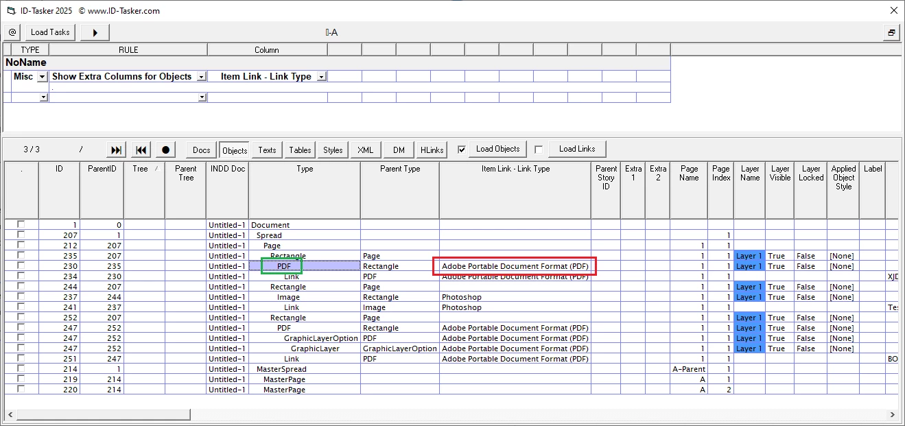

Sorry, I don't have time to analyze the whole code - but you'll most likely need to change this line:
// file must be an image, not null (not embedded) and made by Photoshop
if (placedFile.constructor.name == "Image" && placedFile.itemLink != null && placedFile.itemLink.linkType == "Photoshop" ){
to:
if (placedFile.constructor.name == "PDF" && placedFile.itemLink != null && placedFile.itemLink.linkType == "Adobe Portable Document Format (PDF)" ){
Marked in green is value for "placedFile.constructor.name".
Marked in red is value for "placedFile.itemLink.linkType".
Apr 6, 2025 1:55 AM UTC
Worked perfectly, thank you!

Robert at ID-Tasker
Robert at ID-TaskerCorrect answer
Apr 6, 2025 2:03 AM UTC
@Little_Matty
You're welcome.
This should work for BOTH cases - Images and PDFs/AIs - without the need for two separate scripts:
if ((placedFile.constructor.name == "Image" && placedFile.itemLink != null && placedFile.itemLink.linkType == "Photoshop" ) || (placedFile.constructor.name == "PDF" && placedFile.itemLink != null && placedFile.itemLink.linkType == "Adobe Portable Document Format (PDF)" )){
But then, for clarity, you can edit all the comments where Photoshop is mentioned 😉
