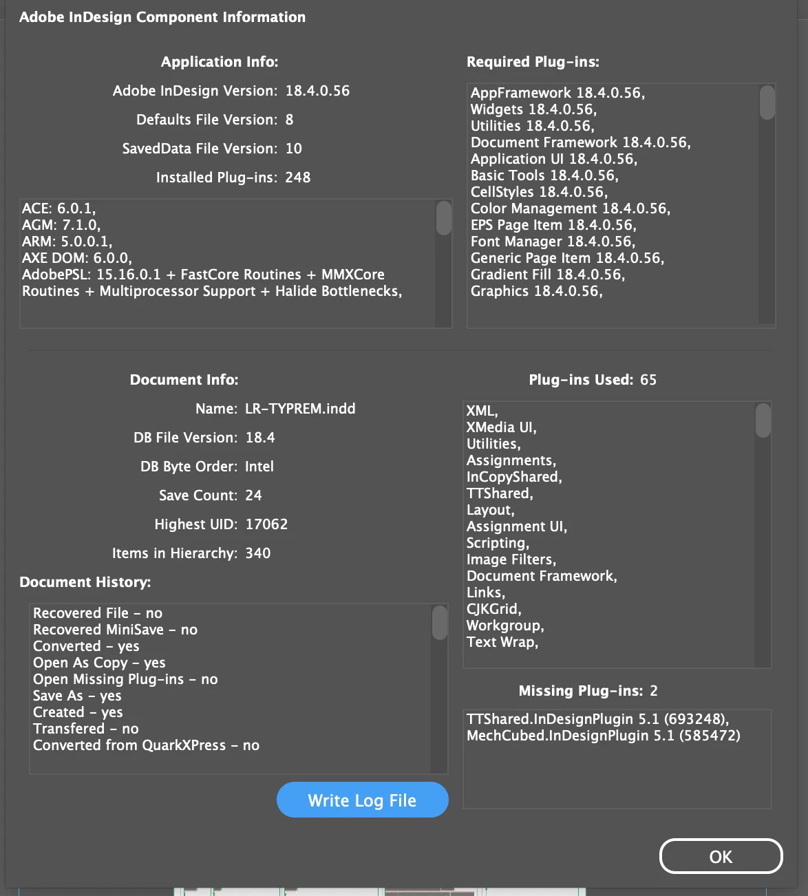

If you have a MAC then open the document in InDesign, then click InDesign menu(top left), then click Cmd + About InDesign. It shall give you all the information about the document along with the plugins used and the missing plugins. See the screenshot below
P.S.:- On windows use ctrl instead of cmd, the menu would be in the Help menu.

I did check the plugins as suggested, this works well. But this showed no plugins missing or what I could tell custom plugins.
