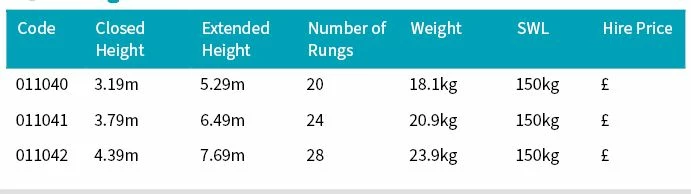

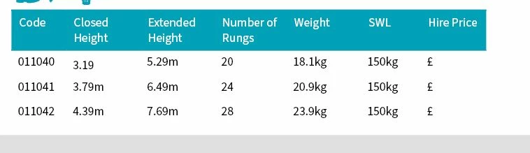

I hope someone can help me I've been working on this brochure project for around 18 months. I've had no issues during this time. Last few days, I wanted to make some changes to some products but when I edit something it shifts down by a small amount.

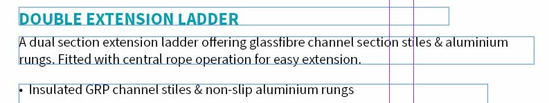

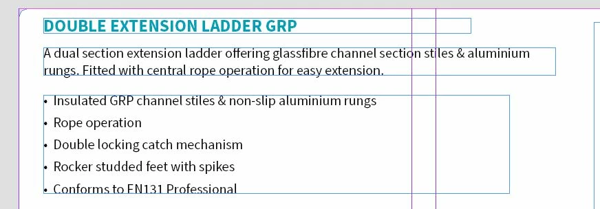

Product text box goes from 3mm (h) to 3.612mm (h) - I have attached images to show me deleting some text below.
The font size doesn't change, there's no difference between that text box before and after deleting some information and replacing it I've reviewed the baseline options and haven't got anything set does anyone have any suggestions?
